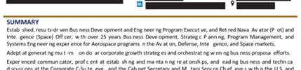

I am redacting a series of documents (emails and attached files mostly).  When I apply the redactions and save as a new "redacted" version, the characters "i" and "l" disappear throughout the document.
I am redacting a single PDF of many pages of emails and attached files.  This issue seems mostly within the emails.
Also, I tried printing to PDF unredacted versions of the troublesome pages, then reapplying redactions.  I get the same problem.
Is there a fix for this?

October 26, 2023
I had the exact same thing happen. My Acrobat Pro version is 2023.006.2360, and I am on WIndows 10 version 10.0.19045. The .pdf was generated via MS Word, and everything was fine doing the base search for redaction terms. After applying the changes and saving the new version, the document removed all lower-case Ls and Is (e.g., "Supp er s records ( nc ud ng e ectron c records) to ver fy that Supp er has comp ed w th ts ob gat ons under the Agreement Supp er sha not requ re the aud tor to s gn a non-d sc osure agreement that wou d prevent or mpede the aud tor from perform ng ts aud t ob gat ons to..."). Do you have a fix for this, or do I need to go through a different process? I did it three times over with the same results.
