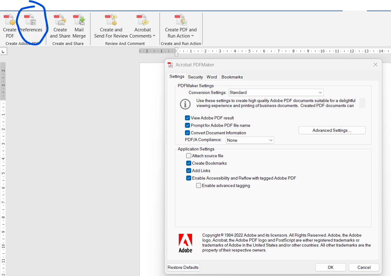

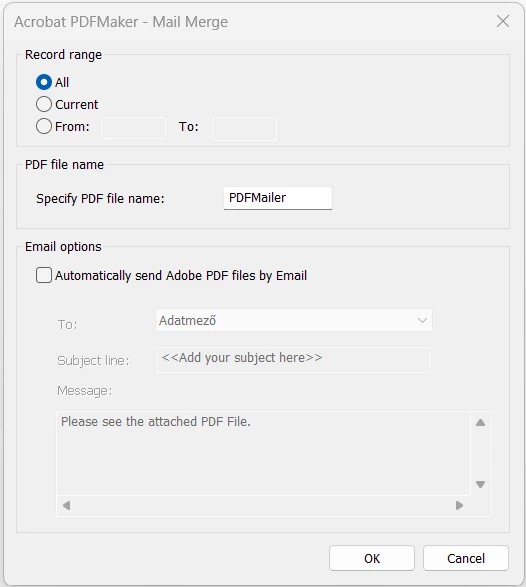

Adobe MS Word PDFMaker Office COM add-in output customization

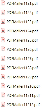

It has a static numbering method in name generation.
I can change "PDFMailer", but the sequence numbers will look:
As I can see there is no option in Acrobat ribbon's Preferences to change this.

Hi @7402662_2770,
Thank you for reaching out. I assume you are looking for a solution to generate dynamic names for the resulting PDFs.
As you have already figured out, this is not quite possible with a built-in option in PDFMaker preferences.

Acrobat is installed.
File names are still being generated as written above. They should be 1.pdf, 2.pdf, 3.pdf etc.
Can you share a post-export renaming AW js sub that renames the merged PDF files based on metadata automatically?
E.g. auto rename PDFMailer1121.pdf to 1.pdf, and so on
