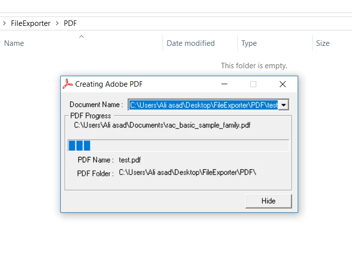

I'm creating an add-in in Revit 2017. The addin will export drawing sheets to PDF files. So, whenever I try to export the sheet a dialog box appears to choose the location to save. I tried to turn off the Prompting programmatically by adding a key to the Windows registry (as described in Adobe documentation page 15-16).
Now, the prompting got turned off and now I'm facing an issue. The issue is the Adobe Printer got stuck while creating the pdf file. See the below image: The PDF creating progress bar seems frozen, I waited for more than 10 mins and it didn't create the pdf file.
Can anybody provide any fix? Appreciate any suggestion.

Thank you but it didn't work either. I'm not sure why this is happening. I'm in a great stress now, tried almost everything that I could but nothing help. Can you share any other solution?

Yes, the PrintToFile property is already has set to true. Below is the code snippet, I hope that may give some idea where the problem is.
        public static bool ExportSheetToPDF(Document doc, string path)
            using (Transaction tx = new Transaction(doc)
                tx.Start("Exportint to PDF");
                PrintManager pm = doc.PrintManager;
                pm.SelectNewPrintDriver("Adobe PDF");
                pm.Apply();
                pm.PrintRange = PrintRange.Current;
                pm.Apply();
                pm.CombinedFile = true;
                pm.Apply();
                pm.PrintToFile = true;
                pm.Apply();
                pm.PrintToFileName = path + @"\PDF\" + "abc.pdf";
                pm.Apply();
                SuppressAdobeDialogAndSaveFilePath(path + @"\PDF\" + "abc.pdf");
                pm.SubmitPrint();
                pm.Apply();
                tx.Commit();
            return true;
        // Add Registry Key to suppress the dialog box
        public static void SuppressAdobeDialogAndSaveFilePath(string value)
            var valueName = @"C:\Program Files\Autodesk\Revit 2017\Revit.exe";
            var reg = currentUser.OpenSubKey(key, true);
            var tempReg = reg.OpenSubKey(valueName);
            if (tempReg == null)
                reg = reg.CreateSubKey(valueName);
            reg.SetValue(valueName, value);
            reg.Close();

A test for you. Does the Revit API allow you to print to a named file (not PDF)? If so, see if you can print the same Revit document to a file, using the Adobe PDF document. It won't make a PDF! But does it finish?
imaliasad
imaliasadAuthor
March 8, 2018
Thank you for your reply. The Revit API does allow us to export drawings in PDF if the save dialog box isn't suppressed. When the dialog box is suppressed by modifying the registry key, the process of exporting the PDF file doesn't get complete.
