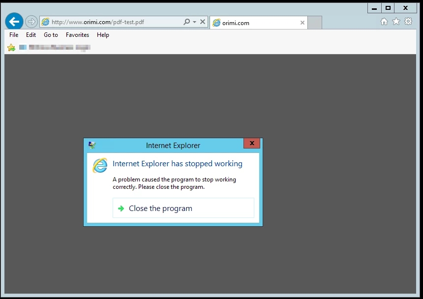

We currently have an issue where Adobe Reader DC 2019.010.20069 Crashes when viewing PDF file on Internet Explorer 11. If you try to view a file on any webpage in IE you are presented with the below image. If you use Google Chrome you have no such issue.

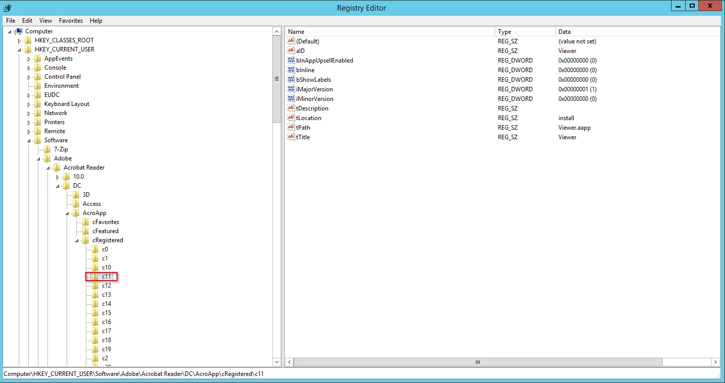

We have identified the issue with a registry key that gets written every time the adobe application has been opened. Location for this key is: HKEY_CURRENT_USER\Software\Adobe\Acrobat Reader\DC\AcroApp\cRegistered\c11
If you remove the c11 Folder and put read only access on the cRegistered key it will stop adobe from recreating the key. Without this key Internet Explorer is able to open the PDF and view in the browser.
