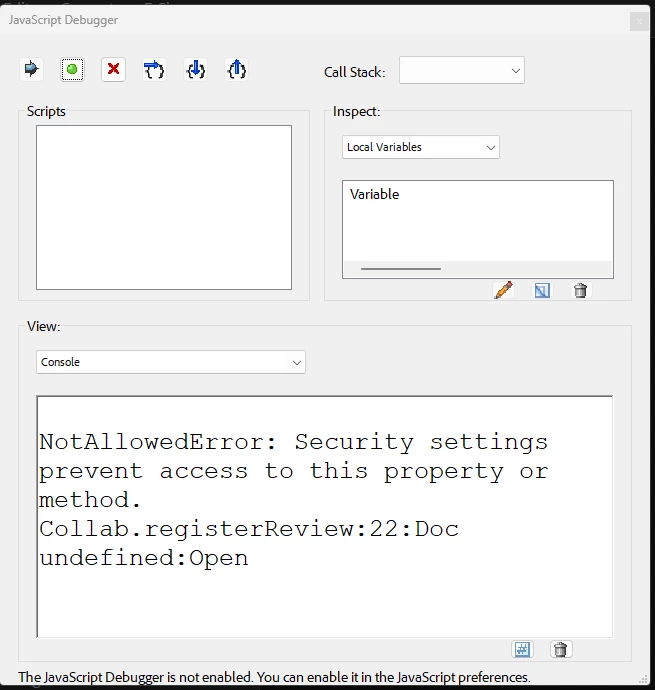

With Acrobat’s JavaScript debugger/console enabled, Reader reports:
NotAllowedError: Sicherheitseinstellungen verhindern den Zugriff auf diese Eigenschaft oder Methode.
Collab.registerReview:22:Doc undefined:Open
text
A screenshot of the error is attached separately.

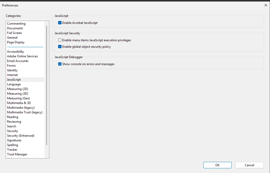

  • Acrobat JavaScript is enabled.
  • Protected Mode and Protected View were disabled for testing.
  • Our domain and relevant paths were added to Acrobat’s trusted/privileged locations.
  • These trust and URL configuration changes did not resolve the issue.

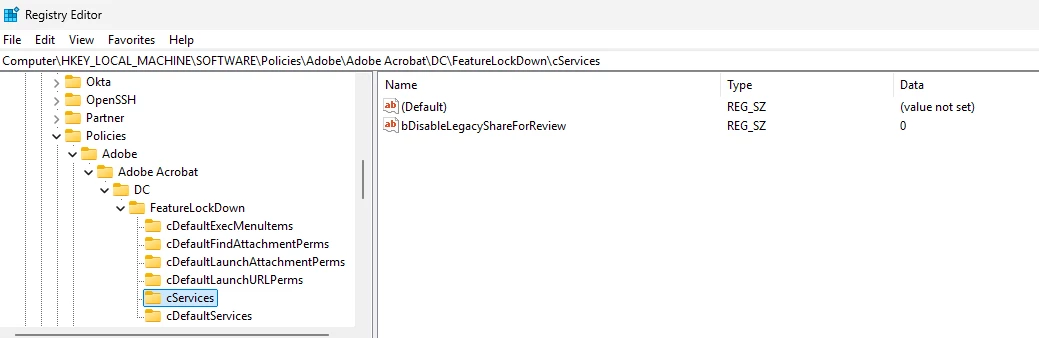

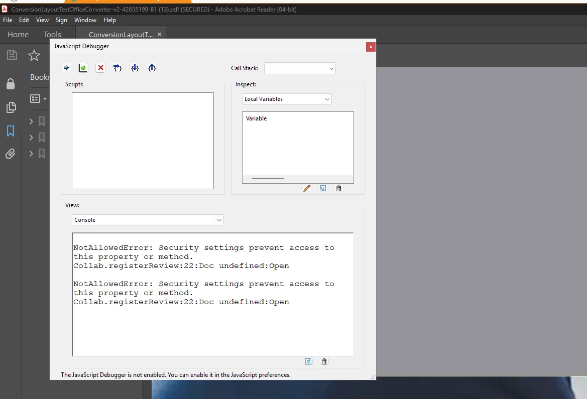

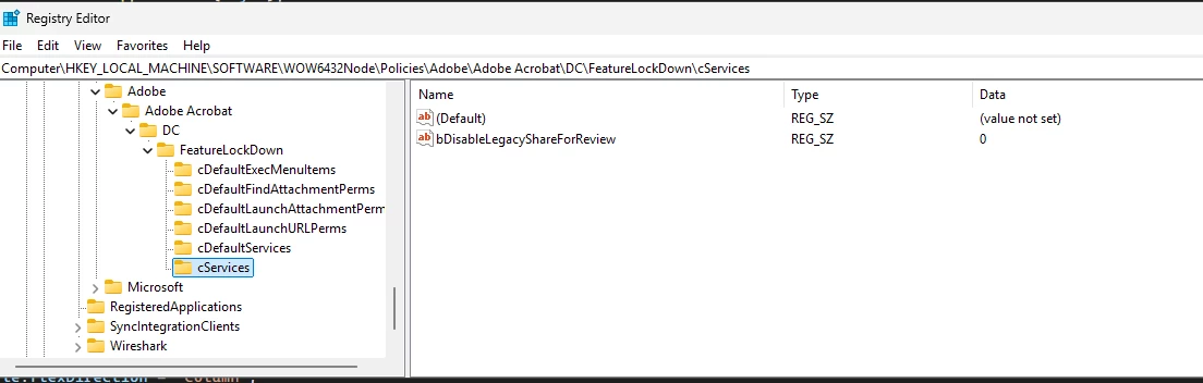

    I am the developer who is investigation on our side into this issue and a co-worker of ​@skillful_Lilyda0d.
    Just adding the missing screenshots here:
    Setting in the suggested node:
    Seting in WOW64 node:
    Error message with "Show console on errors and debugging" on
