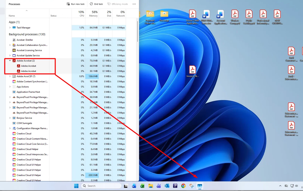

I’ve been experiencing an issue very similar to what others have described, where Adobe Acrobat does not appear to launch.
When users open the application, nothing happens on screen. However, if you check Task Manager, multiple background processes are created. Because there is no visible response, users tend to click the application multiple times, which results in many instances of Acrobat running in the background.
My assumption (speculation) is that the application begins to launch but fails partway through the process. As a result:
  • The GUI never appears
  • No error message is displayed
  • Additional launch attempts create more background processes
As a temporary workaround, I’ve been:
  • Opening Task Manager
  • Ending all Acrobat-related processes
  • Relaunching the application successfully
However, this issue occurs multiple times per day.

April 1, 2026
Hi ​@Joshua27140953w9bi,
Thanks for reaching out, and sorry for the inconvenient experience. Also, thank you for providing detailed information about the issue.
Right now, we need to make sure Acrobat is up to date. To check the latest updates available, please visit here: https://www.adobe.com/devnet-docs/acrobatetk/tools/ReleaseNotesDC/index.html
If the app is up-to-date and the issue is still reproducible, please help us with the following information:
To collect the logs: Download and run the Diagnostics Utility from:  https://helpx.adobe.com/acrobat/kb/acrobat-diagnostics.html
  • Click on Start Diagnostics. Ensure advanced logging is checked.
  • Launch Acrobat, reproduce the issue with your file.
  • Once done, click Stop Monitoring.
  • Copy the Log ID and share it with us.
We would also need these logs: https://helpx.adobe.com/acrobat/kb/collect-logs-crash-freeze.html
  • Upload logs to any Cloud Drive(One Drive, Google Drive, Dropbox, etc)
Appreciate your patience.
~Tariq
