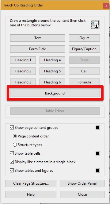

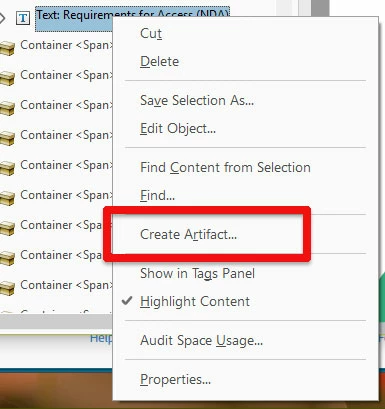

Repeating footers should be marked as background artifacts.
January 31, 2018
Thanks. And, how do you do that?
Dave__M
February 2, 2018
One way is to right-click on the tag itself in the Content panel and select Create Artifact... from the popup list.
You can further define the type in the next dialog box.
Or, using the Reading Order tool, you can select a tag on the page to select it, and click the Background button on the Touch Up Reading Order panel.
