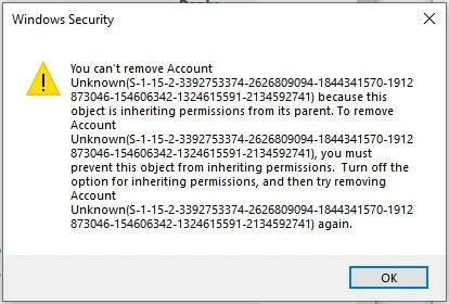

"I FOUND A SOLUTION.
I had to go C:\Users\[me]\AppData\Local and right click the Adobe folder, click properties and go to security tab. I had a bunch of left-over "Account Unknown" listed besides my three main ones (System, [me], Admin). I deleted all the account unknowns."
If you can't delete all the Account Unknown files through "EDIT", select "ADVANCED" and remove them.
Spread the word. I didn't even have to reboot after doing this and my error disappeared.

This really could use some official documentation from Adobe. I'm sure they know about it the issue, and why it is caused. Very frustrating to have to scour forums to fix this kind of thing.
This resolved my issue. I did initially get an error deleting the account, but I deleted the otherones beneath it and hit apply. This automatically deleted the account I could not remove.

Feb 25, 2023 12:50 PM UTC
RedFeathers • Participante , 19 de octubre de 2022
@markelrayes encontró una solución en otro hilo.
"ENCONTRÉ UNA SOLUCIÓN.
Tuve que ir a C:\Users\[me]\AppData\Local y hacer clic derecho en la carpeta Adobe, hacer clic en propiedades e ir a la pestaña de seguridad. Tenía un montón de "Cuenta desconocida" sobrantes en la lista además de mis tres principales (Sistema, [yo], Administrador). Eliminé todas las cuentas desconocidas".
Si no puede eliminar todos los archivos de la cuenta desconocida a través de "EDITAR", seleccione "AVANZADO" y elimínelos.
Difundir la palabra. Ni siquiera tuve que reiniciar después de hacer esto y mi error
