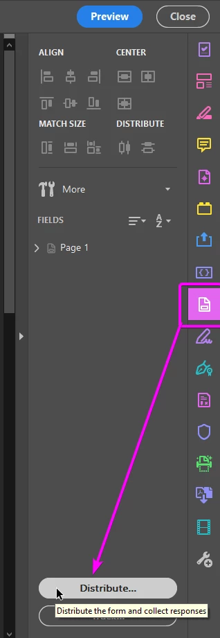

JR Boulay
November 2, 2020
Sending PDFs with a "Send" button is an outdated process.
You should remove this button and try the "Distribute" Acrobat feature.
romy71Author
November 2, 2020
Ooooh thanks
I will test it
