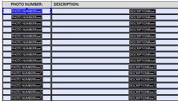

I am attempting to have my photo log auto populate in sequential order.
Lets say I have photo 1450 and I input that into the first field I would like it to auto populate all the way down. What is the best way to accomplish this? any help would greatly be appreciated.
Also, I dont have a lot of experieance to if you decide to help with coding, please post the full code or explanation on how to input it. Thanks again

    Use this code as the custom Validation script of the first Photo Number field:
    for (var i=2; i<=15; i++) {
    	this.getField("PHOTO NUMBERRow"+i).value = (event.value=="") ? "" : (Number(event.value)+(i-1));
