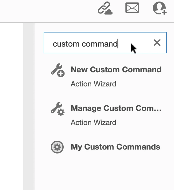

In Acrobat's Tools search function type "Custom Command", this should bring up a "New Custom Command" - select that:

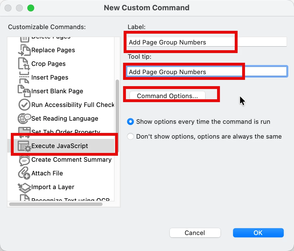

This will bring up a dialog window that looks like this:
Find the "Execute JavaScript" item in the list on the left, then provide a name and a tooltip, and then click on the "Command Options..." button. Now enter the following script:
