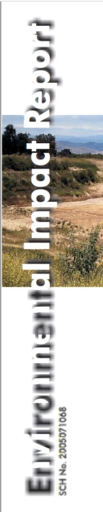

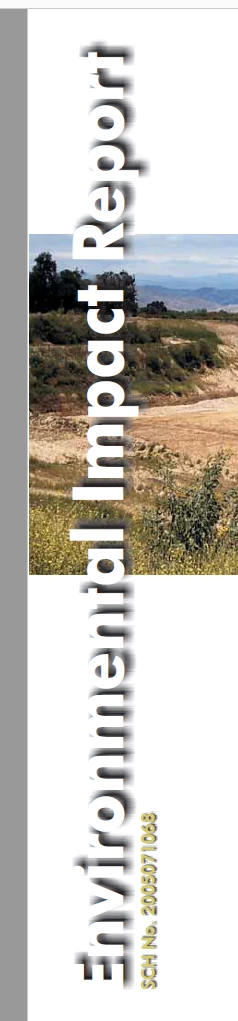

So this is something I’ve noticed while updating a bunch of old pdf report and making them ADA compliant that if I’m not careful when I run Autotag parts of the pdf, usually images or figures as they’re called can disappear and there’s no way to get them back then to close the file and not save the progress that has been made.
Example:
Before Autotag
After Autotag:
To make matters worse if I remove this page from the pdf, autotag it, then put it back it it detects the new page isn’t tagged and flags it as such so I’m stuck doing it.
I’m at a loss at the moment and would appreciate any ideas how to make it not do this.

    I’ve confirmed I am up to date version 26.002.22031.
    I’ve tried both tagging with just local system and tagging with the cloud and both times it removes the figures from the front page as previously shown. Also for the record I’ve found through personal use that autotagging with the cloud creates a lot more problems then just the local machine but that’s an issue for another time.
    When I use Reading Order it does still show boxes where the figures should be but as you can see from screen captures they are not visible anymore.
    Unfortunately this is a file from 2006 and the source is not available.
    It is 100% reproducible as this happens every time I try to make this ada compliant.
    As for the logs I’m unable to collect them as the option does not exist on the menu. How would you like me to provide you the before and after copies of the file?
