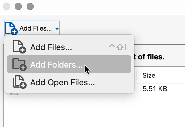

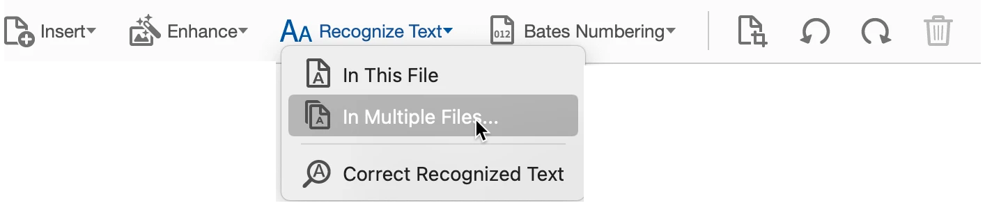

However, to deal with many many individual files, put a bunch of them in a folder. Now, go to the Scan & OCR tool. In the middle you can select one file or multiple files
Once you've selected Multiple Files, go to the folder you want to process and let it process them. The rest should be fairly obvious.
