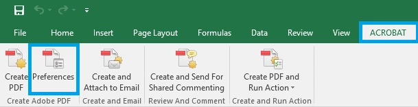

Could you please try changing settings in Preferences under ACROBAT tab:
Launch Excel>click ACROBAT>Preferences>check the box Fit to paper width>OK.
Below are the screenshots:

I have tried these settings and it works so long as there is only one sheet. If there are multiple sheets on a PDF then will only work for the first one.
Thanks for the reply, do you have any other suggestions that may help.
