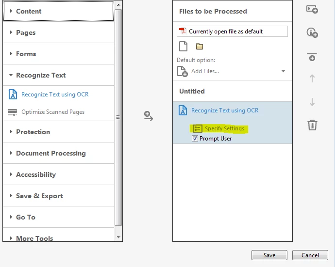

Kindly follow the below mentioned steps to avoid getting a prompt to enter settings while applying OCR to each Pdf:-
1) Click on specify settings:-

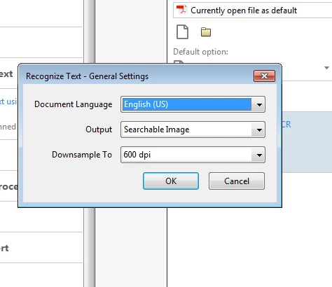

2) You will receive a prompt to specify settings for all of the files as shown below:-
Specify the settings and click on "OK".
3). There is a chcek box just below this option which says "Prompt User" , kindly uncheck this box to receive the prompt for settings for every Pdf:-
4). Click on Save to save your action and run it. You will not receive the prompt to specify settings on every Pdf and also you will be able to OCR on all your files.
