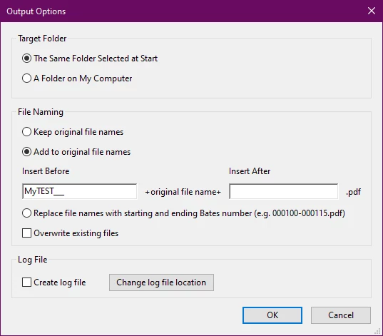

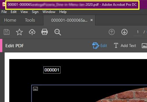

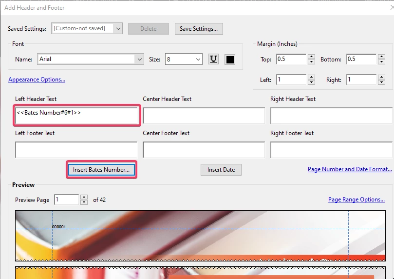

Dave__M
August 18, 2020
I just tried this on my installation of Acrobat Pro DC, and it worked as advertised.
I set the options to Add to original file names, and it made a PDF that had my entry in the 'Insert Before' box at the start of the new file name.  I see an option to Replace file names with starting and ending...  I wonder if this is the feature you're needing? Did you enter the Bates code in the dialog box that shows the header & footer of your page?
