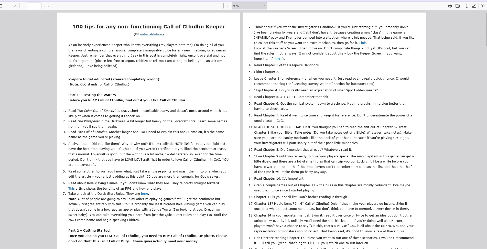

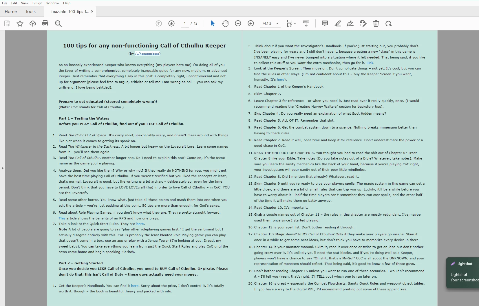

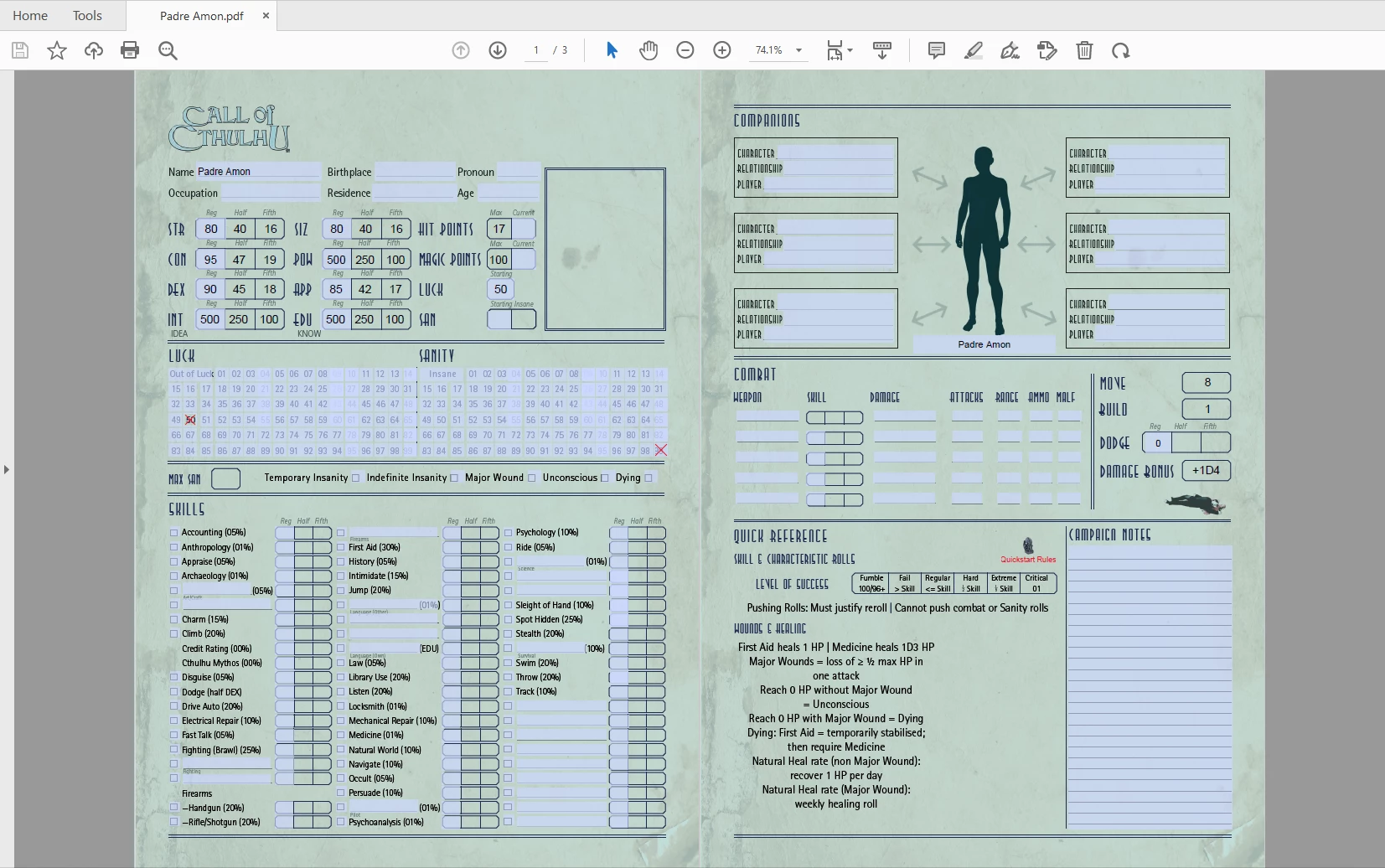

Blue overlay coating on PDFs pages
When utilizing Adobe Acrobat Pro to read PDFs, there's a blue overlay coating all pages of all documents. Opening the very same document on any other pdf reader doesn't present the blue tint. It popped up out of nowhere yesterday and it's quite infuriating. I would like to know how to remove it, if possible. Thanks.

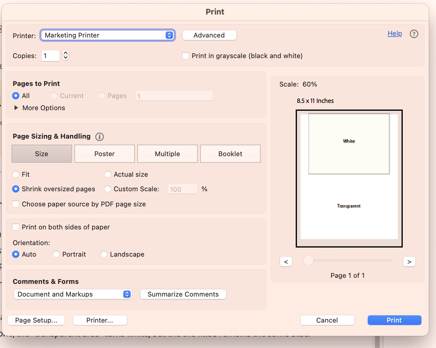

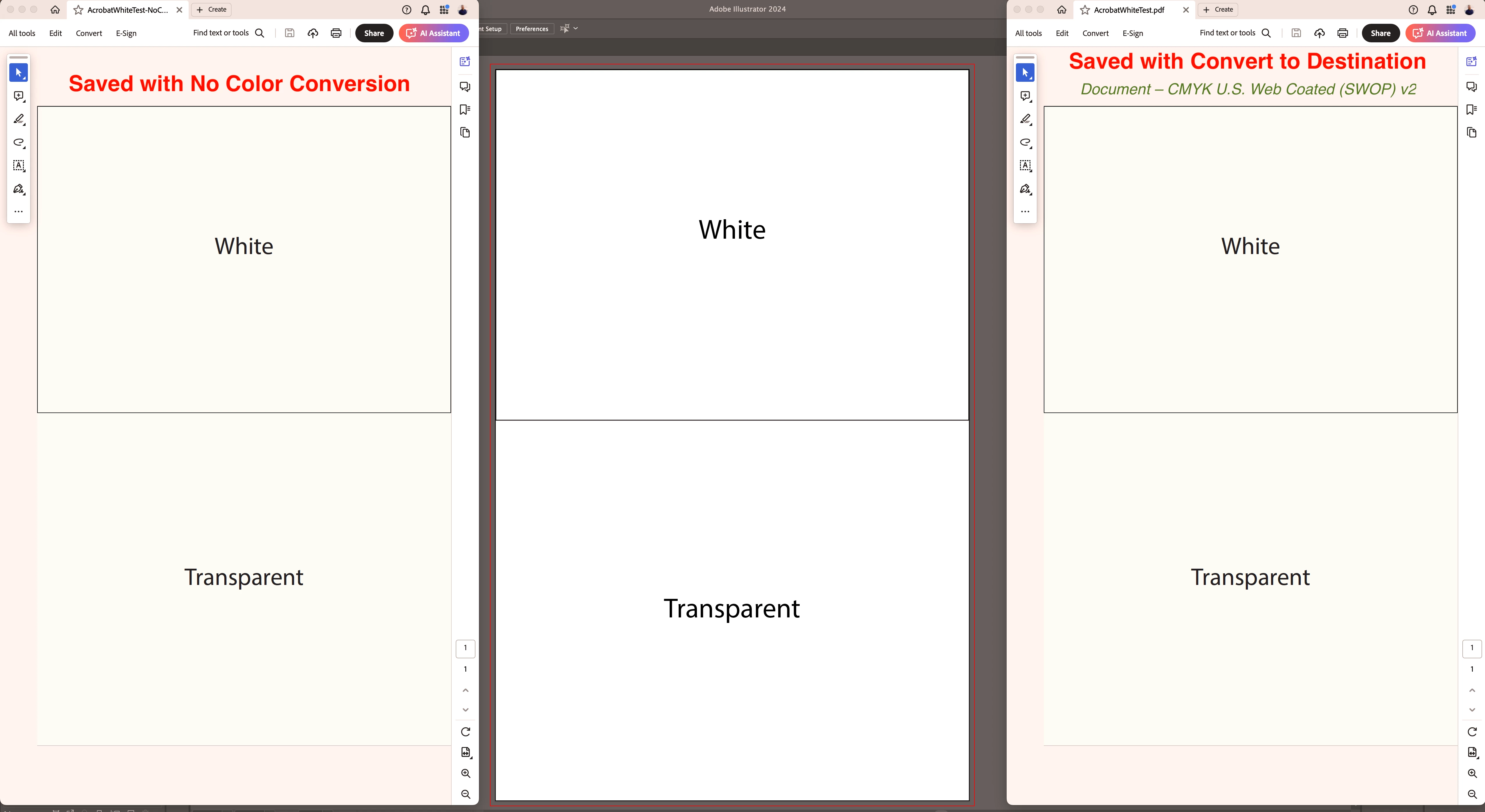

Jun 14, 2024 4:46 PM UTC
I'm again having this issue. I had it at one point and changing my overall color profiles on my system helped, but it's back now and nothing I'm doing seems to have any effect. I've uploaded a screenshot with an original PDF I made in Illustrator in center and two different exported versions showing in Acrobat to the left and right.
The top half was filled with white and the bottom half was transparent. The right one was exported as "High Quality Print" with "Convert to Destination" as the Output (Document – CMYK U.S. Web Coated (SWOP) v2), the left was exported as "High Quality Print" with "No Conversion" as the output selection.
I've tried changing all of the color settings for display in Acrobat and nothing effects it. I've also (as suggested by @bidask555 ) tried uninstalling acrobat, installing reader, uninstalling and then reinstalling DC. No change.
The only thing that makes a difference is if I turn on the Accessiblity setting for Background Color replacement. When I do that, on the converted one, the "transparent area" turns white, but the the filled remains the same blue.
Acrobat is the only product that does this. Preview on macOS works fine, all other adobe apps work fine and viewing in a browser works fine. They also print fine. Its just a very maddening problem.
Also attached is a screenshot of the print settings window (with accessibility color replacement turned OFF) and it shows the "white" area as blue but the "transparent" area as white.

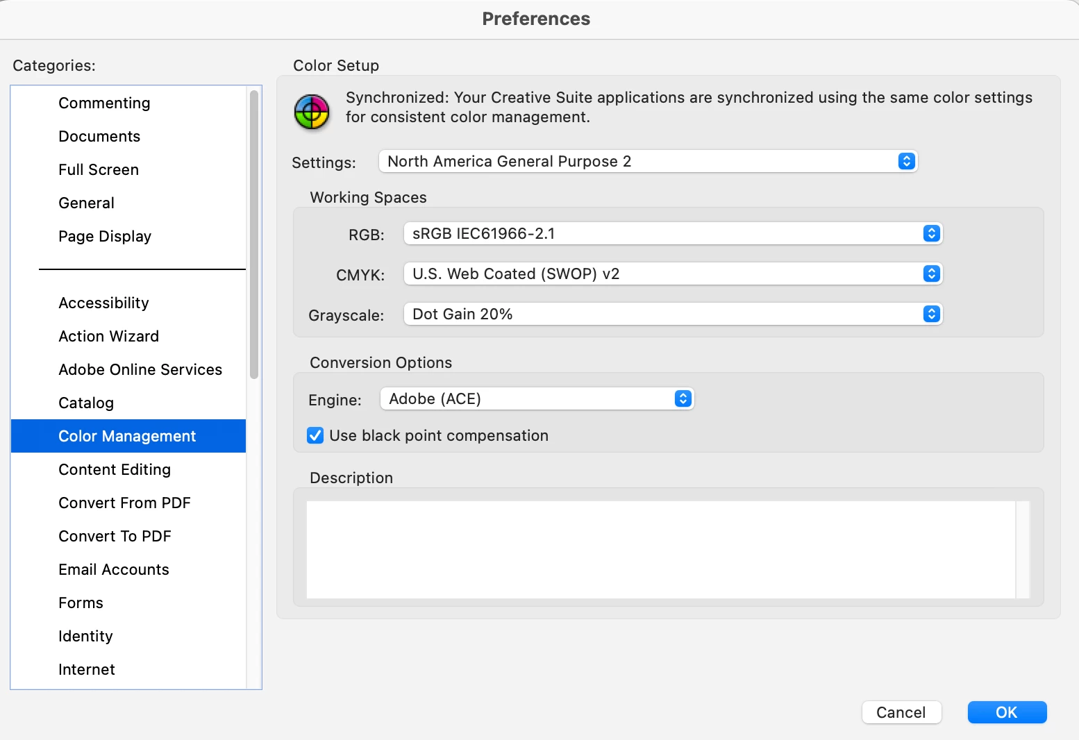

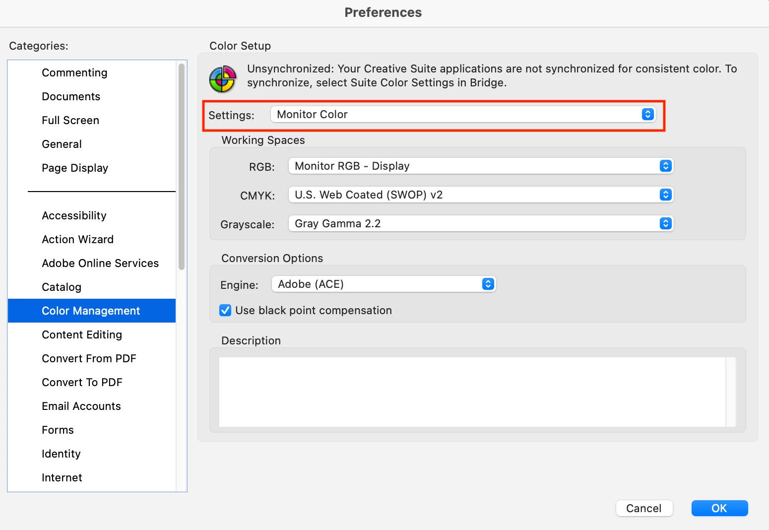

Feb 1, 2024 3:58 AM UTC
I've had this same issue for the past six months. It started not long after switching from an Intel powered Mac to the M1.
The solution for me was changing the Colour Setup settings. Go to 'Preferences> Color Management' and change 'Settings' to 'Monitor Color'. Mine was strangely on North America General Purpose 2.
I've attached examples below:
Mar 8, 2024 8:15 AM UTC

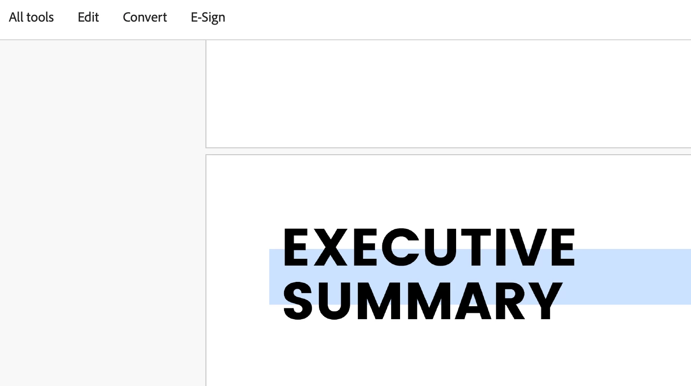

Sep 5, 2023 9:17 PM UTC
Issue still outstanding. Every single PDF statement that I download - typically monthly financial statements - appears with a light blue tint ONLY in Acrobat Pro.  Preview and any other app it appears white as intended.
This is a new behavior in the last few updates for Creative Suite and has nothing to do with forms, with image vs text page, with protected/locked vs unlocked page, with selection or no selection.  Just opening a bank statement is blue.  Really infuriating.

Hi Paulo 2201,
Thank you for reaching out.
We have checked the images, and it seems to be the form fields. In Acrobat, when you add form fields, they appear in blue.
Would you mind sharing the original PDF so we can confirm?
Let us know if you have any questions.
Meenakshi

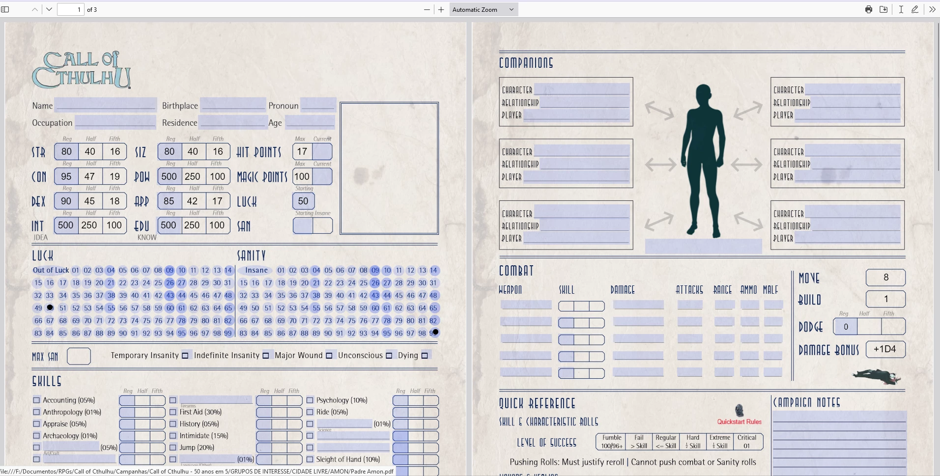

Feb 24, 2023 7:06 PM UTC
The pdf is attached. As you can see, it is completely blue, like if I have layered a blue hue over it. The screenshot_24 compared to screenshot_25 is completely blue. I'm not refering to the blue forms boxes. I'll attach another example
