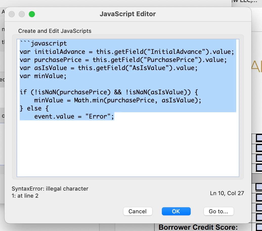

The formula listed above didn't work. ChatGPT told me to enter the following formula but it's giving me an error saying "SyntaxError: illegal character 1: at line 2"
Formula looks like this:
```javascript
var initialAdvance = this.getField("InitialAdvance").value;
var purchasePrice = this.getField("PurchasePrice").value;
var asIsValue = this.getField("AsIsValue").value;
var minValue;
if (!isNaN(purchasePrice) && !isNaN(asIsValue)) {
minValue = Math.min(purchasePrice, asIsValue);
} else {
event.value = "Error";
PDF Automation Station
November 3, 2024
Remove ```javascript
That is a heading that is not supposed to be in the script.
