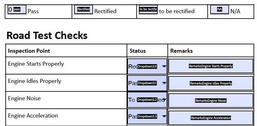

Hi
I am creating a inspection report, with a list of inspection items. At the side of each items, I have a dropdown list of Pass, to be rectified, N.A. At the end of the report, I want to show the total number of "Pass" selected, "to be rectified" and "N.A". I only need to know how many passes are there, how many "to be rectified" are selected and so on. How can I do that?

What are the names of those fields?
MINT TEEAuthor
June 26, 2024
Pass, Rectified, to be rectified, N.A. In the dropdown list also these 4 items.
try67
June 26, 2024
OK, then you can use this code as the custom calculation script of the field that counts the number of "Pass" selections:
var total = 0;
var fields = this.getField("Dropdown3").getArray();
for (var i in fields) {
	if (fields[i].valueAsString=="Pass") total++;
event.value = total;
Simply adjust the string in the fourth line to re-use it for the other values.
