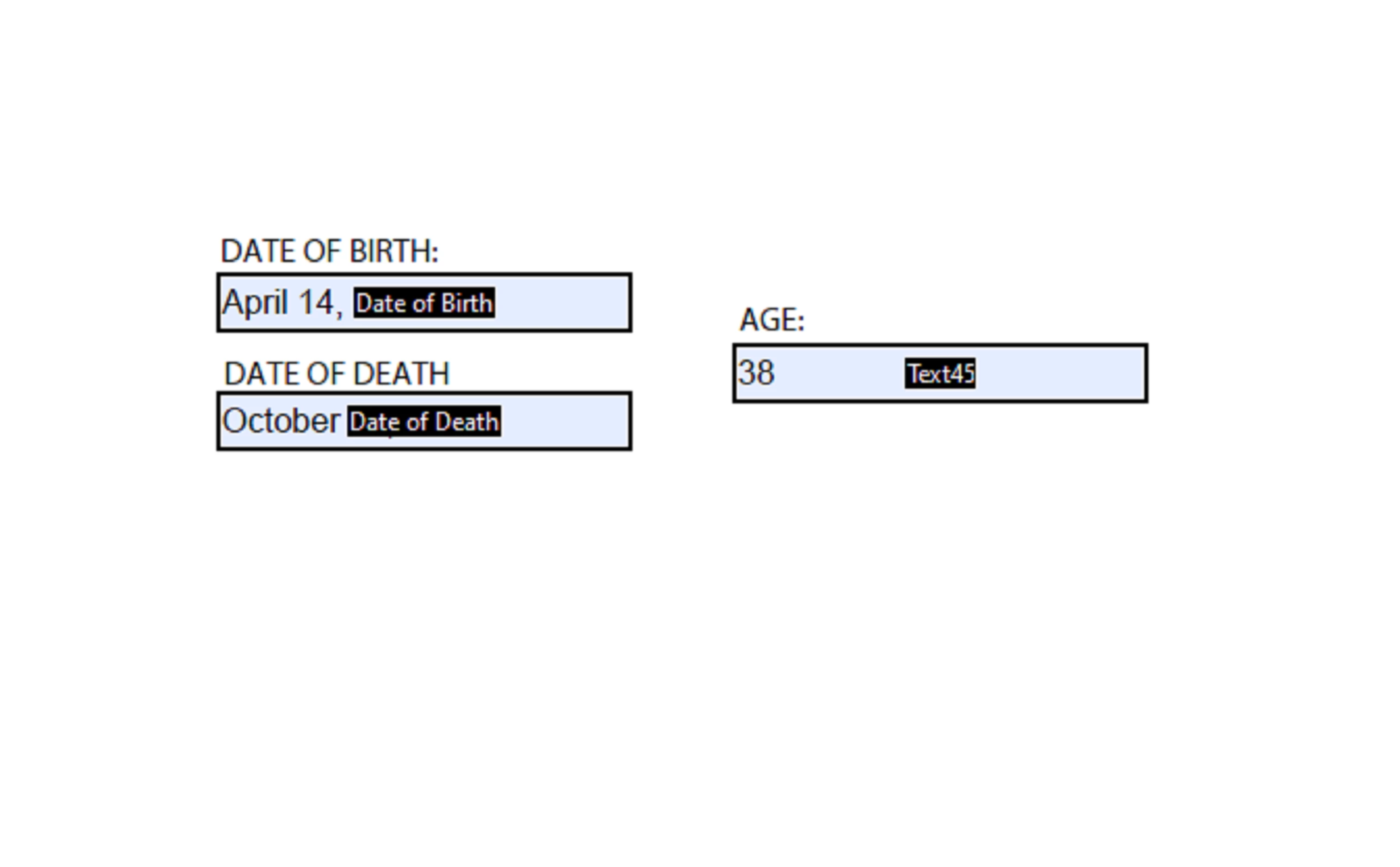

Sorry I made a mistake in my prior reply.
 I missed the part of  calculating the miliseconds in the time difference "diff" variable.
Here's the finished script:
//Custom calculation script to calculate Age based on date of birth and date of death
var birth= this.getField("Date of Birth").value;
var death = this.getField("Date of Death").value;
 if (birth.length && death.length) {
     var dateBirth = util.scand("mmmm d, yyyy", birth);
     var dateDeath = util.scand("mmmm d, yyyy", death);
//calculate the difference in miliseconds between the death date and birth date
     var diff = (dateDeath.valueOf() - dateBirth.valueOf())/1000;
// calculate years
     var age =   (((diff / 60) / 60) / 24) / 365;
//round off the total using  util.printf() method
  event. value = util.printf("%0.0f", age);
See slide below:
