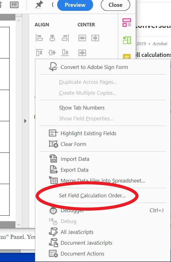

The update problem you are seeing is caused by calculation ordering.  You'll need to make sure that calculations that depend on each other are properly ordered.  To set calculatin order, select the "Prepare Form" tools and click on the "More" menu.
