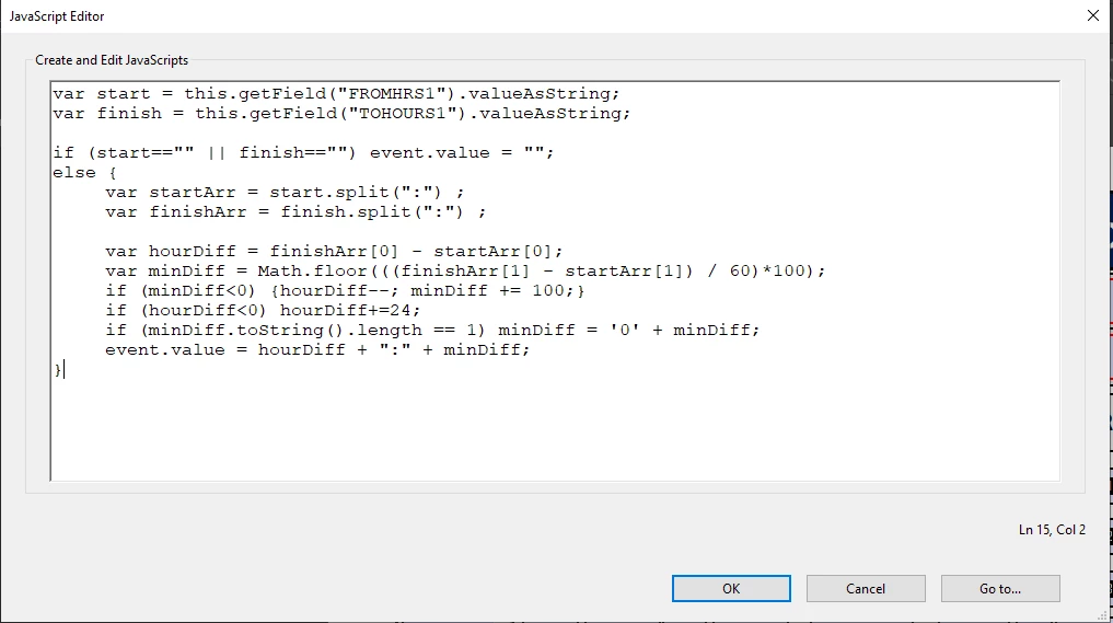

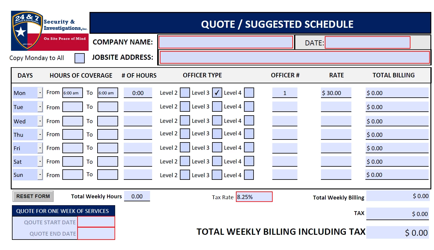

I have a quote form I've created.  It works pretty great unless I need to calculate (or show) a 24 hr period which I can't seem to figure out how to do for the life of me.  If I put in the time of 6:00AM to 6:00 (as seen in the attached) it calculates to 0:00 hours instead of 24 hrs. Any solutions?
Correct answer try67
In that case you can just add an exception, like this:
if (hourDiff==0 && minDiff==0) hourDiff = 24;

Can the result be more than 24 hours? If so, you will have to specify the full date, or the script won't be able to know if 9:00 - 10:00 is one hour, or 25 hours, or 49 hours, etc.
May 23, 2022
No.  The max time per line is 24 hrs.
