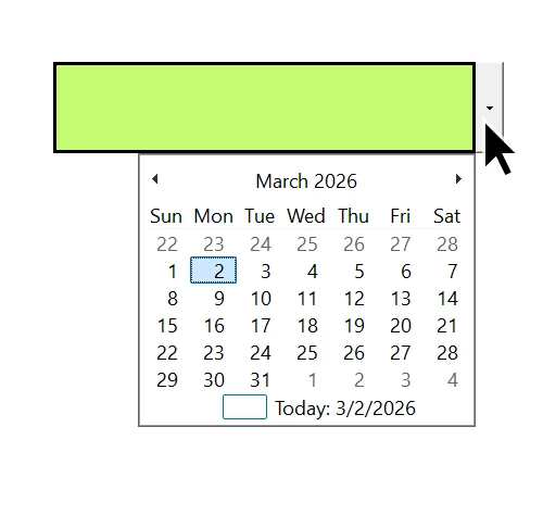

Calendar Widget from drop down missing
Hi everyone,
for whatever reason I am now missing the dropdown calendar widget that I could previously use in a form.
Did I miss something? (v25.001.21265, fresh update)

    So my main issue (after Dave Creamer started helping, thanks again) is that me and my colleague are missing this dropdown. I’m using Windows and he is using Mac.
    I already reinstalled the software AND (for other reasons) I had to reinstall Windows.
    Sadly I cannot tell when it stopped working but it must have been between now and mid January.
    This all makes no sense to me.
    Any idea is appreciated
    Dave Creamer of IDEAS
    Mar 2, 2026 3:39 PM UTC
    Are you referring to this:
    Clever_Wizard6705
    Mar 2, 2026 3:42 PM UTC
    Yes, exactly.
    The field still only uses my format for dates but it won’t show the button anymore for the dropdown calendar
    Mar 2, 2026 4:57 PM UTC
    I just created this field in a new form, so obviously it works. You only see it in view mode, not editing mode. May not show up in non-Acrobat apps, however.
