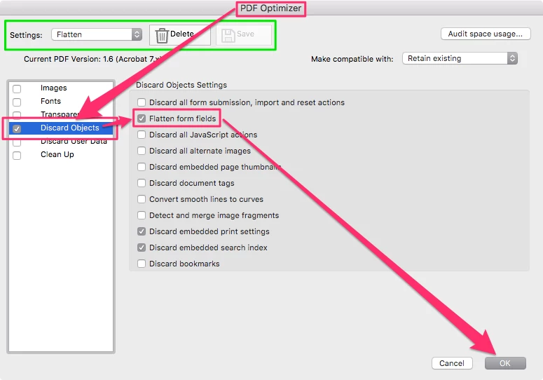

You can use the PDF Optimizer too, and save the setting:

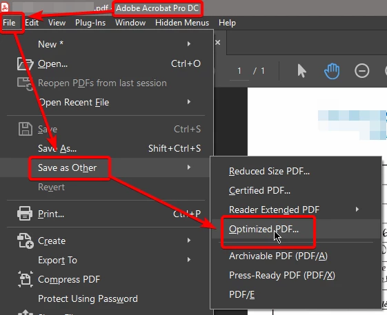

How do I access the functionality you are referring to?
If I search Help for PDF Optimizer I get no results.  I see none in the menus.  The only functions I have that reference the word "optimize" are the compression and OCR options and those do not have the parameters you are referencing nor does the interface look like that.
I am using the Mac version of Acrobat Pro DC.

To access the PDF Optimizer in Acrobat Pro DC use File > Save as other > Optimized PDF. (Note: flattener preview refers to a different kind of flattening - transparency flattening. There are at least four different things which people call "flattening" for PDFs, adding to the confusion. In the UI, it means only a kind you aren't interested in.)
(By the way, flattening forms is NOT a kind of security, as some web sites foolishly claim!)
