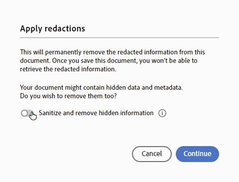

Abambo
October 19, 2023
Check this option when applying the redaction:
However, you will need to know and check if none of the hidden information needs to get removed.
