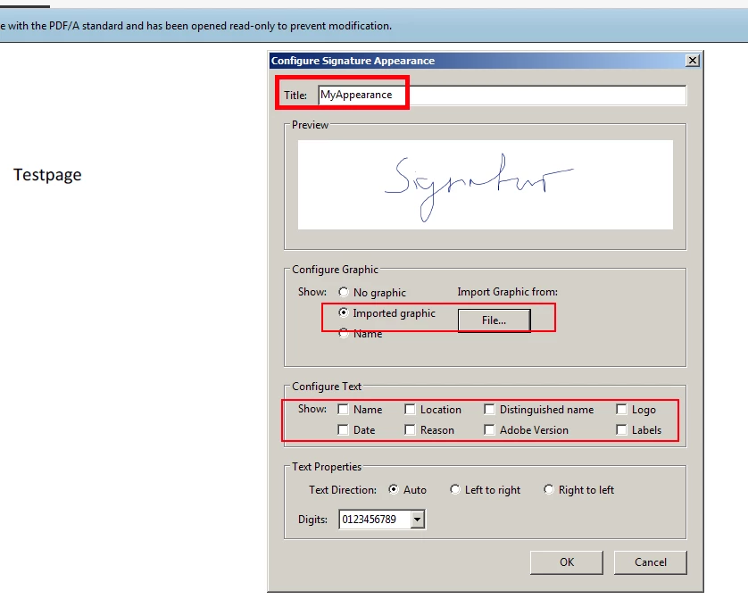

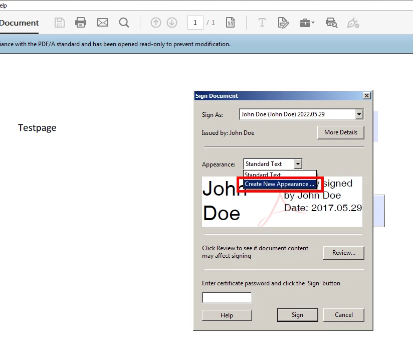

Ok since Adobe Acrobat doesn't include the font - just use an image as appearance. To do that use the following steps:
1. In the signing dialog use the option "Create new Appearance"
2. Define a title, import any graphic and unclick all texstual elements like name, location etc.
3. Et voilà - your perfect valid signature :-)

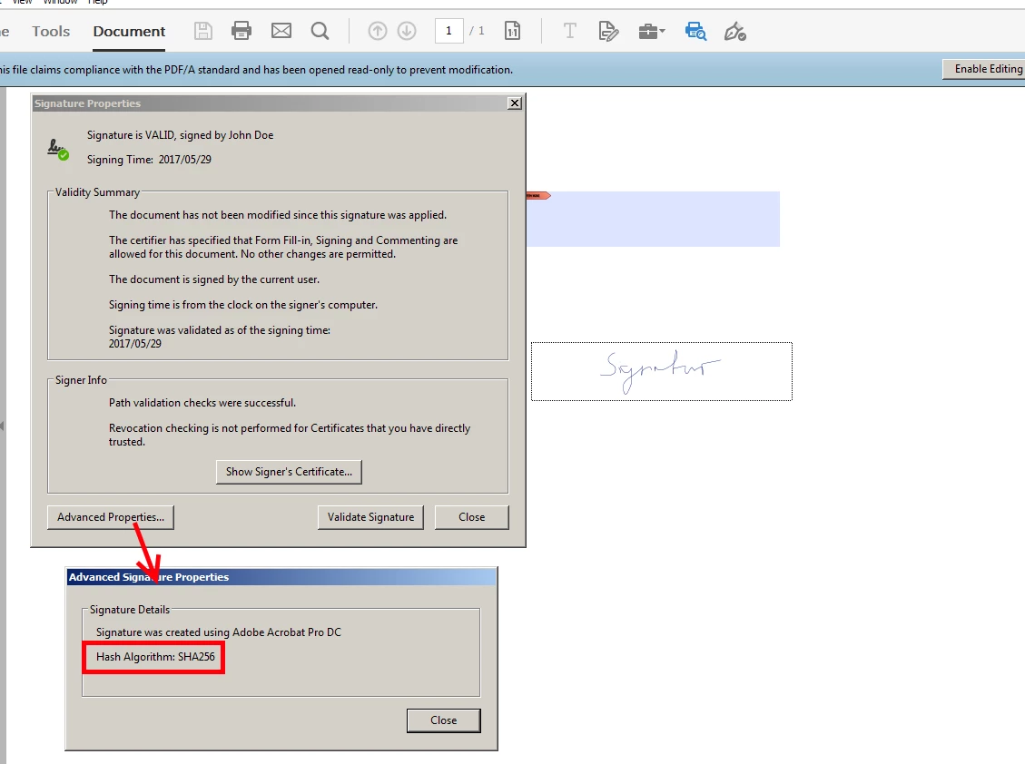

4. If you look at the properties its a SHA256 signature

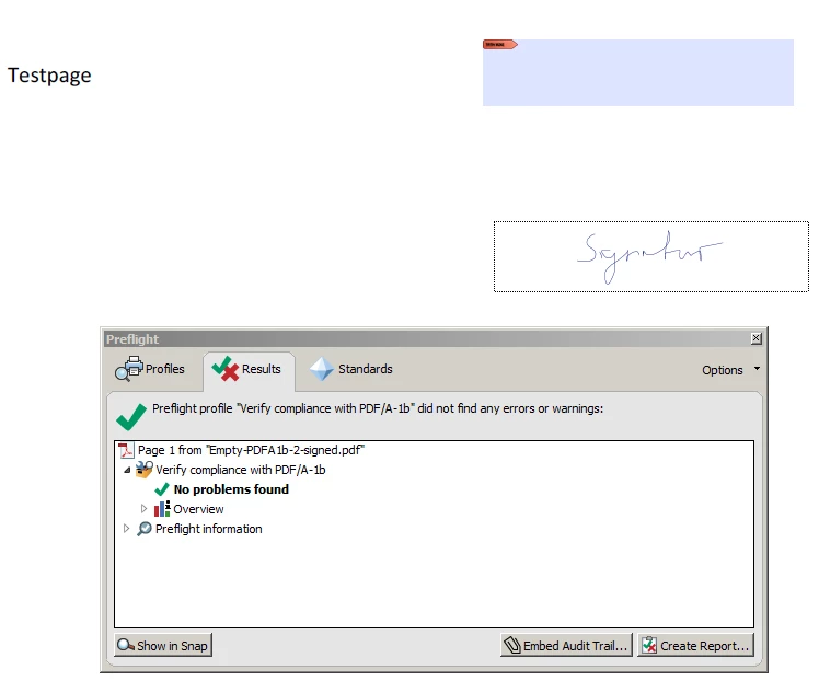

I got it to work the following way:
1. Create a document which contains a signature field
2. Convert it to PDF/A-1b

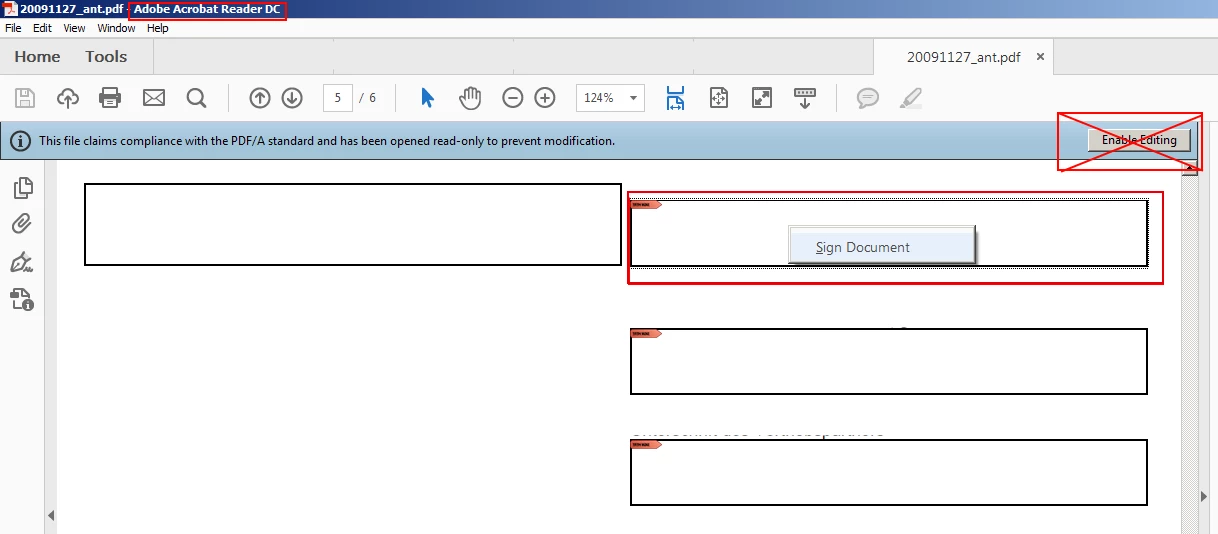

3. Open it with Adobe Reader (DC) or Acrobat
4. Do not click on the "Enable Editing" Button
5. Right click on a signature field and a greyed out "Sign document" dialog will pop up
6. Create yourself a test certificate / use an existing if you already have one
7. Save the document and open it with Acrobat again and run the PDF/A-1b preflight check
8. Voilá a perfect valid PDF/A-1 document
It seems that Adobe Acrobat / Reader removes the PDF/A entry when clicking on "enable editing" - and since its not PDF/A anymore it can compress its streams ....
