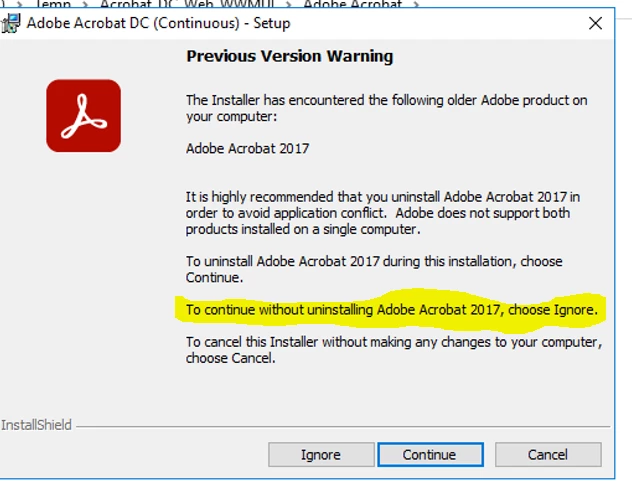

So on our server, we have Adobe Acrobat 2017 installed and we have a new acrobat dc that need to install on the same server. May question is, can we retain the old one which is Adobe Acrobat 2017 if we install the Adobe Acrobat DC?
What will happen if we choose Ignore? do you think it will continue to install the Adobe Acrobat DC and it will not affect the current installed Adobe Acrobat 2017 functionality?
Really appreciate any response.
Thanks in Advance.
Correct answer Test Screen Name
No, you can't have more than one version installed. Except by accident (this particular combo may work, but could fail any time).

Test Screen NameCorrect answer
July 26, 2022
July 26, 2022
thanks 🙂
