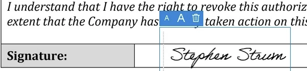

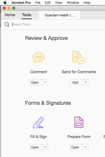

I also upgraded from Acrobat Pro XI to Acrobat Pro DC.  I am able to sign a document with fields that are fillable.  See screenshots below regarding the sequencing of steps:
#1. Below is what Acrobat Pro DC looks like on my computer. I select "TOOLS", then findd "Fill & Sign" in the Forms & Signature area and select "Open".  See more below screenshot.
#2. After the "Open" is clicked, my Acrobat PDF has below the main menu the following:
I then L mouse click on sign and get the drop down menu that has my saved jpg file of my signature. See the next screenshots.
#3. I simply click on signature and drag and drop into the signature field as shown below.
I hope this helps solve your problem.

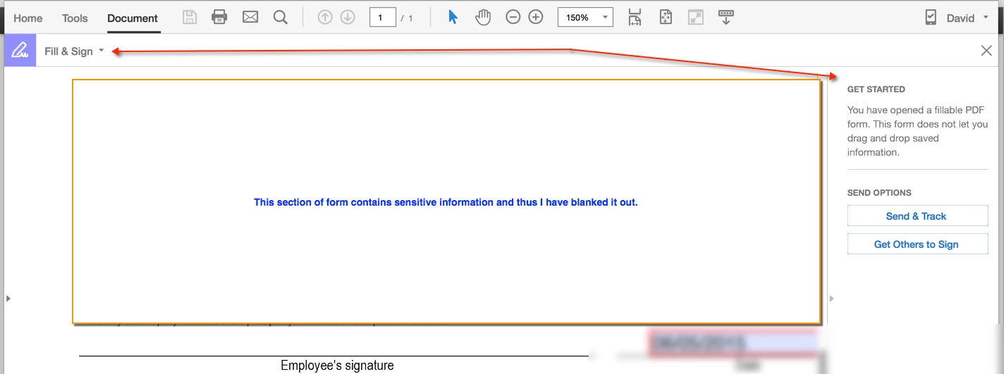

dave_martin
May 10, 2015

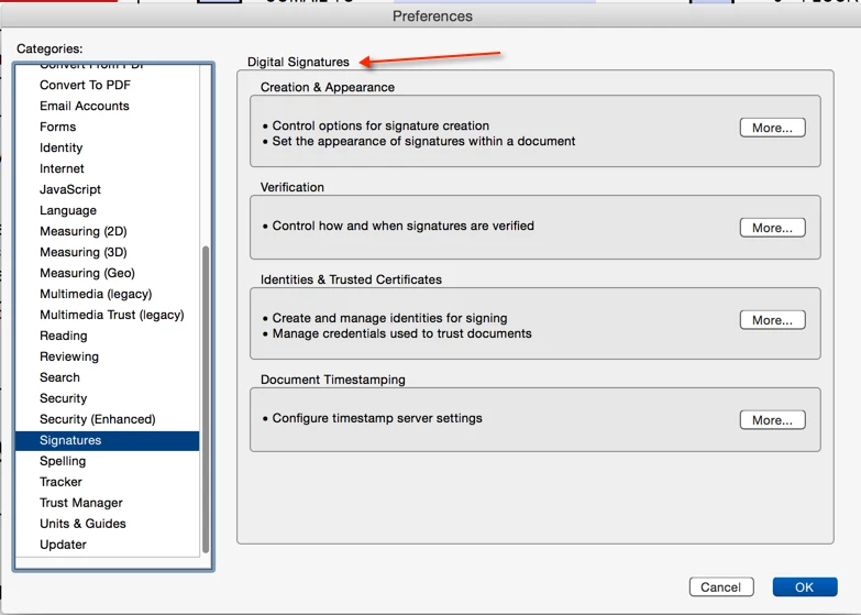

Hi Sukrit,
Thanks for your message.  The Signature Settings in Preferences which you mention appear to apply only to Digital Signatures:
What I want to use is an "Electronic Signature" consisting of a scan of my signature on a piece of paper, which is contained in a .jpg file, and
not a Digital Signature.
Here is the screen shot of what I am experiencing... I blanked out the Document contents itself as it contains sensitive information but you can see that
when I open Fill and Sign I immediately get the message on the right... "Get Started:  You have opened a fillable PDF form.  This form does not let you drag and drop saved information"
With Acrobat Pro XI this worked perfectly using the very same fillable PDF form that I am trying to sign here.
DC seems only to want to use Digital Signatures or EchoSign, neither one of which meets my needs.
