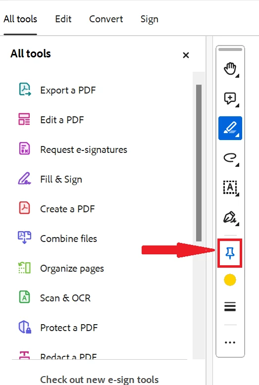

October 18, 2023
can you provide more information on this, possibly a screenshot of what you are referring to. I am using Adobe Pro and do not see the icon that you reference. The help page manual does not provide any additional detail.
Thanks
Amal.
October 18, 2023
Hi there
Please check the screenshot below nd see if that works.
~Amal
