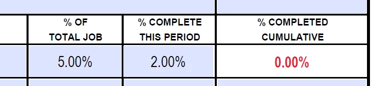

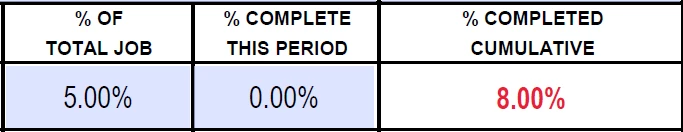

I have a PDF form that i have 3 columns however If column  colums shown below:
What i want to do is %completed cumalitive  can not exceed % of Total Job column but show cumulative total of the project less the % complete this period. I am not sure this is possible as i havent had any luck yet making it work

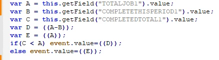

i have tried the below code with no luck

At what field does you use this calculation?
June 24, 2023
thanks for your response  the 3rd column does the calculation . but cant seem to get it to do the correct math. it is not supposed to exceed the column 1 amount
I think i am getting closer however as i mentioned above it can not exceed the column one amount

Looks like that you use a recursive calculation.
Nesa Nurani
June 24, 2023
In what field do you use that script, and where did you put it?
June 24, 2023
thank you for the response the calculation is done in the  3rd column or  % Completed Cumulative
Basically It supposed to track the column 2 progress up to the total of column 1  hope that makes sense
