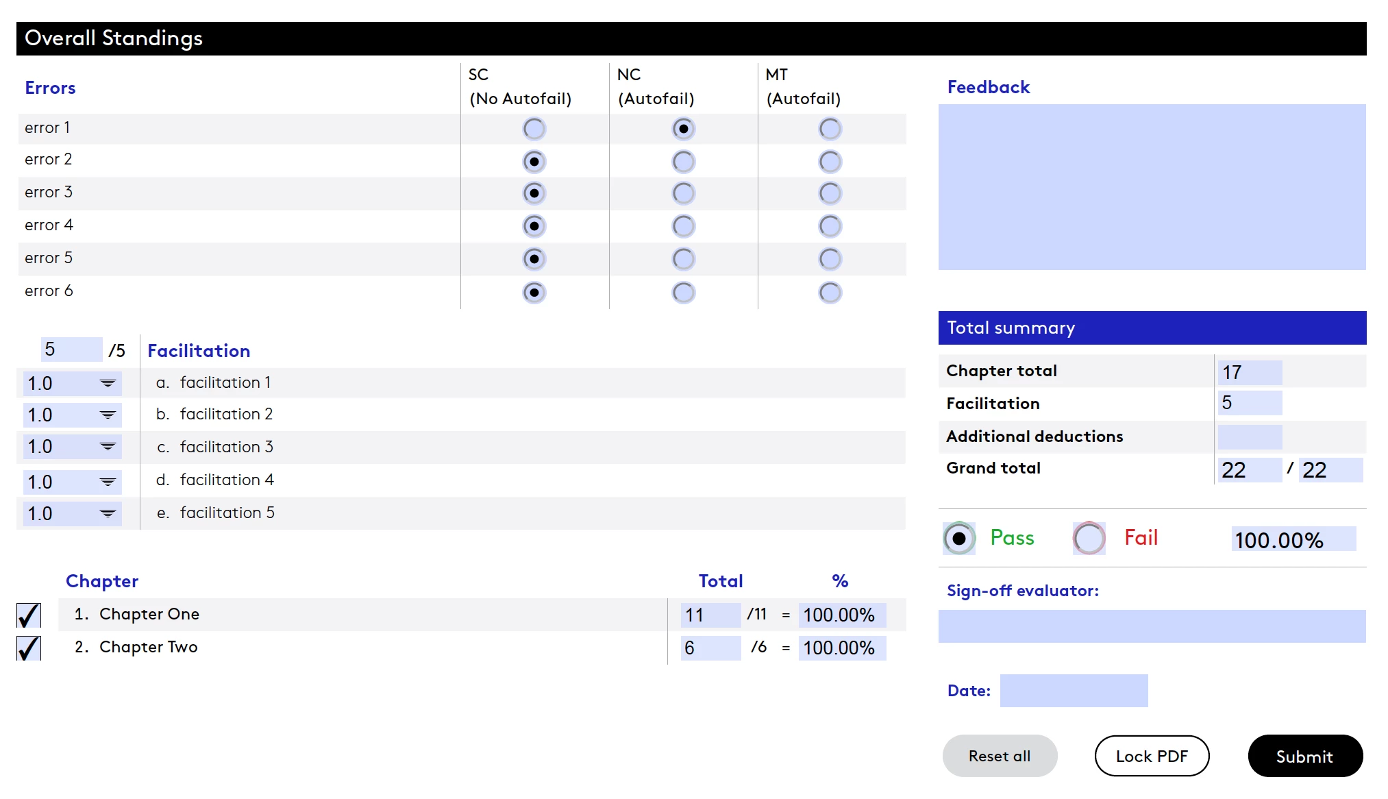

I'm working on customizing a test that uses a lot of totals that funnel into a final percentage. The totals are sums of dropdowns that add between 0 and 1 point to the score (plus there is a text field for deductions at the end). Eventually there is a final total and a percentage. The percentage uses both the Calculate tab and the Validate tab.

However, I'm trying to add automatic fail functionality that works off a set of radio buttons (so even if the score is over 90%, having one of these radio buttons selected will fail the test). I previously tried doing this with checkboxes as well. If I put the code directly into the radio or checkboxes, I can mostly get the live update to work. Ideally I'd like to have it all in one spot though, in the validation field mentioned above.

..Which sort of works, but nothing actually happens after you change the radio button. The change doesn't reflect in the Pass/Fail radio buttons until I update a dropdown or field as well, which changes the final total. I'm wondering if this is because those are all connected throughout the calculations, whereas the radio buttons only show up in the process at the very end in that one validate tab? I'm a bit of a javascript notice and sometimes unsure of how acrobat decides things in calculations. Any advice would be helpful!

Where did you place this code, exactly?
hevromero0
May 24, 2023
I placed the code into the last field in the chain of calculations (in the image as the 100.00% next to Pass and Fail. More specifically into the Validate tab.
