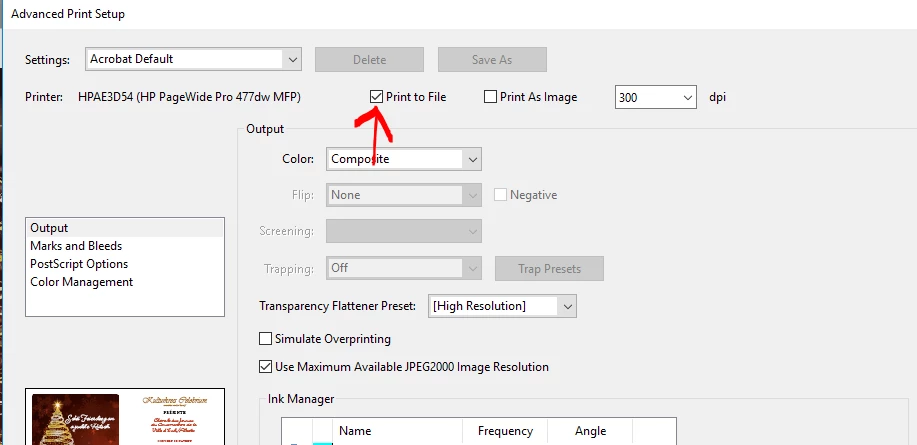

I did now and I got exactly what I used to get with this checked, a file with the pages that I selected to print.
Thank you very much.

There's normally only one. But did you do what we said, turn off Print To File. What happens exactly?

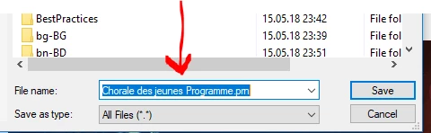

What is prn, in the first picture above the file name ends with .pm? This is also what I see sometimes, other times ps.
With 'Extract Pages' each page is put into a distinct file. Earlier I could use 'Print to File' to get a section, say a dozen pages, out from a long document into one new file. The automatic file extension was pdf or if not I could change at 'Save as type'. How can I do that now?

It's actually prn (P R N) not pm, but that's not important.The previous replied showed you exactly what to click to turn off Print to File.
Print to file does always and exactly what it is designed to do: makes a PRN print file for the current printer. Your current printer is an Epson, you'll get an Epson print file.
I am guessing you actually want to make a new PDF? Don't do it that way. Use Extract Pages from the Organise tool, and save the result.

Your request is difficult to understand. So I'm reformulating what I meant to get out of it:
You are printing a file and when you hit print you get a screen asking to enter a filename:
That is not "printing" but creates a file for the selected printer that could be send differently to the printer.
Make sure that in the advanced print setup screen "Print to file" is not selected.
If "Print to file" is unselected, you're printing directly to the selected printer.
