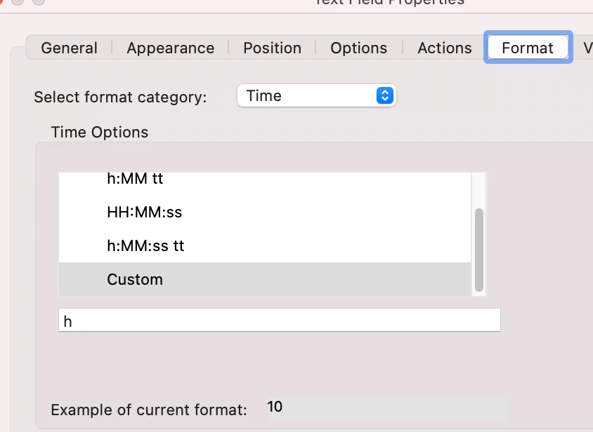

What am I doing wrong?  Yes I searched for help, but I'm not seeing a solve.
I want to be able to calculate hours, but that's a discussion for later.
I have a Text Field that I want to be Formatted to Hour as "h" only.  So I can write 1, and that's it.  But when I try to just enter "1" in there, I get "The value entered does not match the format of the field "
Thanks for your time!

Thanks all for your help.  Regarding my initial question, I found the answer is rather simple.  I have the Format noted above as "h" but when I tried to just write "1" in the field, it came out as Wrong Format.  What I needed to write is "1:00" and then it appears as "1" in the field.

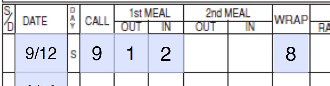

Why do you need format for just one number?
September 22, 2021
Hi Nesa, it's going on a Timecard, and we write in each space the hour.  So I'd write 9 for call (start) 1 for lunch 2 for return and 8 for wrap.

That's not an hour value. Just use the Number format.
