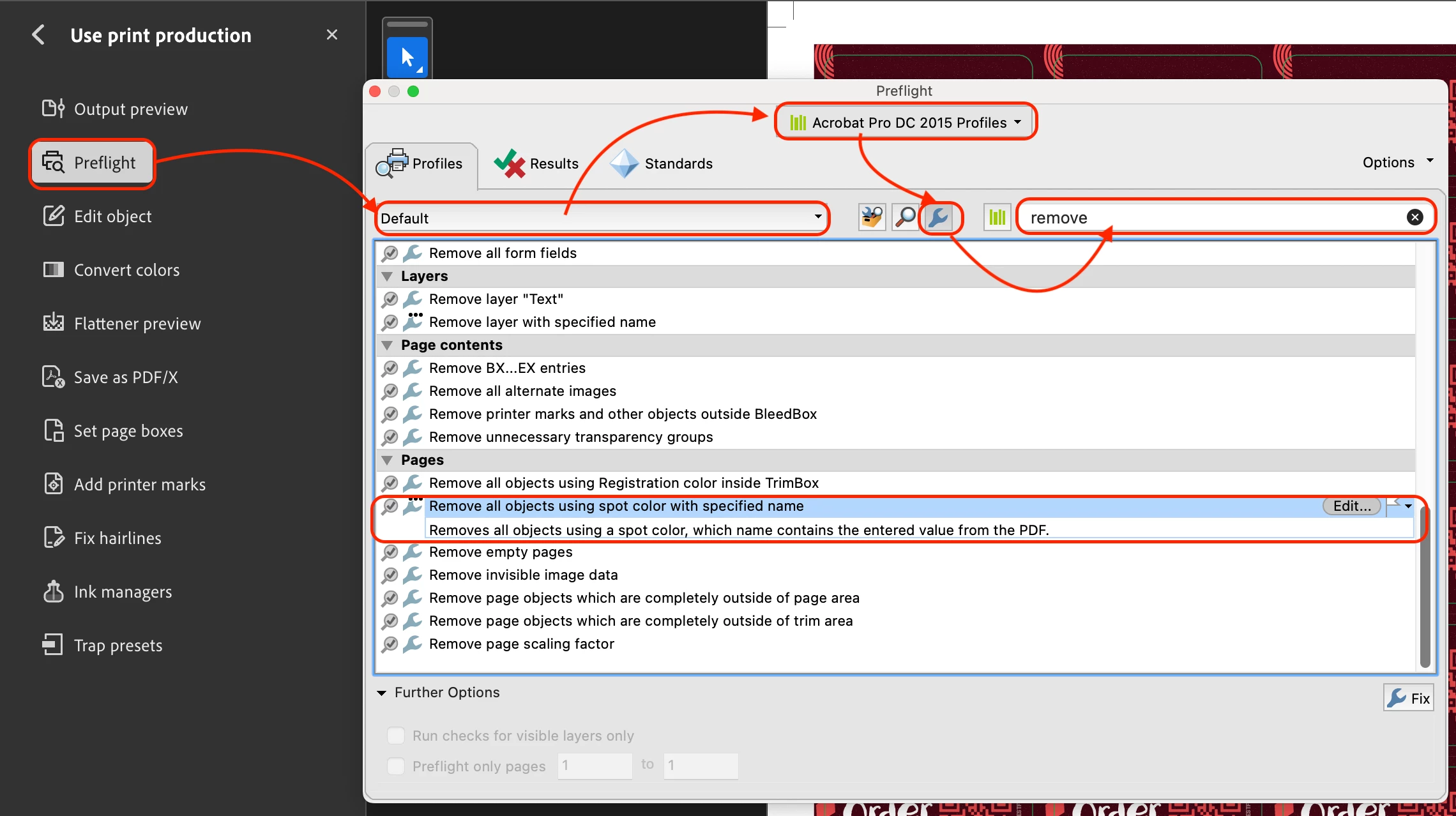

Yes, it is possible to remove a specific PMS (Pantone Matching System) spot color from a PDF using Adobe Acrobat Pro’s Preflight tool. Here’s how you can do it:
Using Adobe Acrobat Pro’s Preflight Tool:
1. Open the PDF in Adobe Acrobat Pro.
2. Go to the Preflight Tool:
  • Click Tools > Print Production > Preflight.
3. Select the Wrench Icon (Fixups):
  • In the Preflight window, click the Wrench icon (this filters for Single Fixups).
4. Search for “Remove”:
  • In the search bar, type “Remove” (not “Spot Color”).
  • Locate “Remove all objects using spot color with the specified name.”
5. Modify the Fixup (if needed):
  • Click Edit, then enter the exact name of the PMS spot color you want to remove.
6. Apply the Fixup:
  • Click OK, then Apply to remove the spot color.
Let us know how it works.
