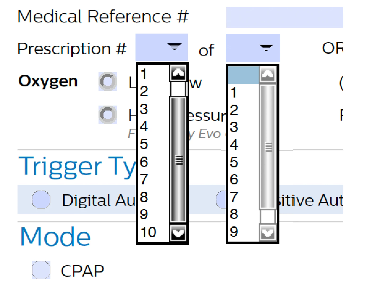

Referring to my screenshot, I'm wondering if it's possible to limit the options of of the second combo box based on the option chosen in the first one. So that you can't have a situation where the combo box number is smaller than the first combo box (e.g Prescription # 4 of 2). Is this possible?

Nesa Nurani
September 20, 2022
If you select default value, do you want second dropdown to be empty or populated with numbers from 1-10?
What is the name of second field?
September 20, 2022
So you want only higher numbers to appear in second dropdown field?
If you select 5 only 6,7,8,9,10 should be in second field?
What if you select 10 in first field?
danielw42205661
September 20, 2022
Well I guess I should have said the same number or higher. So if 5 is first field, second field should only allow 5,6,7,8,9,10. So you can have 10 of 10.
