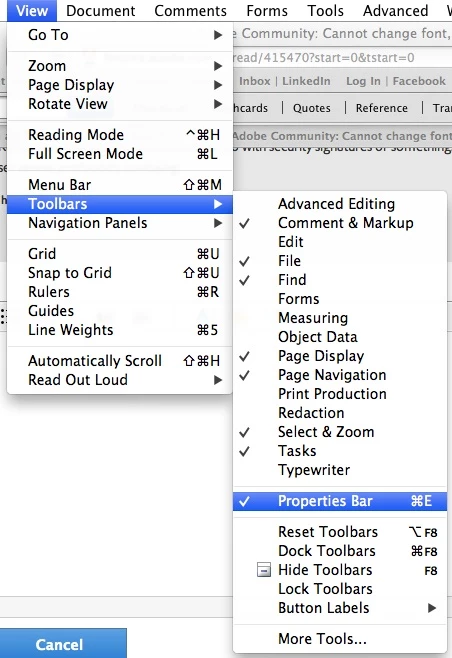

May 16, 2013
Changing the font size is possible in Adobe Pro 8, but it depends on how you are adding text to the document. I generally use the text box to add text to most documents and the only way to change the font is to activate the "Properties Toolbar". Go to View >> Toolbars >> Properties Bar and select this feature.
Once it is activated you can dock the tool bar with the rest of them. after enabling the properties bar when you double click in a text box you will be able to chang the font and font size. Not sure why this is not explained in help, but this is the only way to edit fonts in text boxes.

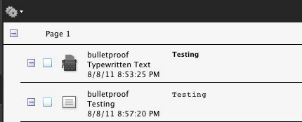

August 9, 2011
I'm not sure what the solution is, but I have some information that might help shine some light on this issue (which has also become troublesome for me). In doing some investigation in what caused this issue to occur, and how to resolve it, I found that the "Typewriter Tool" and the Commenting & Markup's "Text Box Tool" appear to be very closely related...
When this problem appeared for me, and I could no longer edit the font for my Typewriter entries, I noticed that in the "Comment View" pane these entries no longer had a "typewriter" icon next to them but instead had a "text box" icon next to them; as follows (I created a new Typewriter entry so you could see the comparison):
I also noticed that there was a difference in the Properties boxes when you double-clicked on each item, but now seeing that this may be irrelevant, I have decided not to include the 6 screen shots showing their differences.

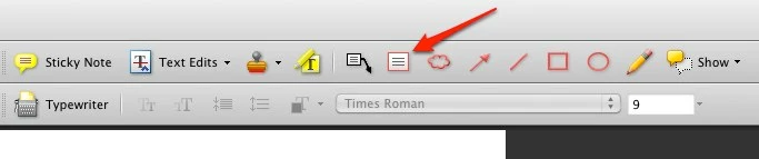

In trying to figure out what would create a "text box" icon instead of a "typewriter" icon in the "Comment View" pane, I found that it was the Commenting & Markup's "Text Box Tool" (as pictured below) that would do just that when using it to add text to a PDF.
I have yet to find a way to convert a Commenting & Markup's Text Box (back) to a Typewriter Tool Text Box via the Comment View pane, or any other means, other than doing it manually.
