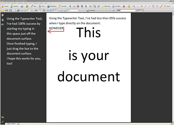

September 29, 2009
I believe I have good news for all who have this trouble. It's been annoying since day one.
I accidentally discovered that by setting your cursor just off the edges of the document and begin your typing, the font properties always remain easily available!
Once you have created a typed message (any number of characters is okay), you can then drag the filled-in Typewriter Text Box to any location on the document; and you can continue to edit, at will!
Using the Typewriter Tool, I've had less than 05% font selection success when I type directly on/in the document.
Using the Typewriter Tool, I've had 100% font selection success by starting my typing in this space just off the document surface. Once finished typing, I just drag the box to the document surface. I hope this works for you, too!
See image. To enlage this image, press your Ctrl key and scroll. Good luck!
September 30, 2009
Thanks for the tip! Will keep this in mind the next time we have to fill a form with Adobe. Much appreciated.
