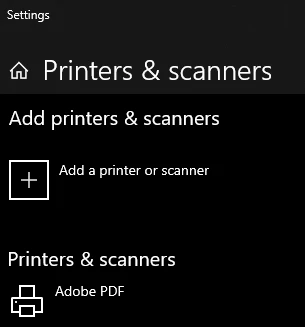

November 20, 2024
The printer properties are in your operating system settings.
Such as for Windows 10,  find the "Printers and Scanners"
Click Adobe PDF
Press Manage
then Printing Preferences
then uncheck "Rely on system fonts"
then OK and you'll be set until it somehow gets checked again.

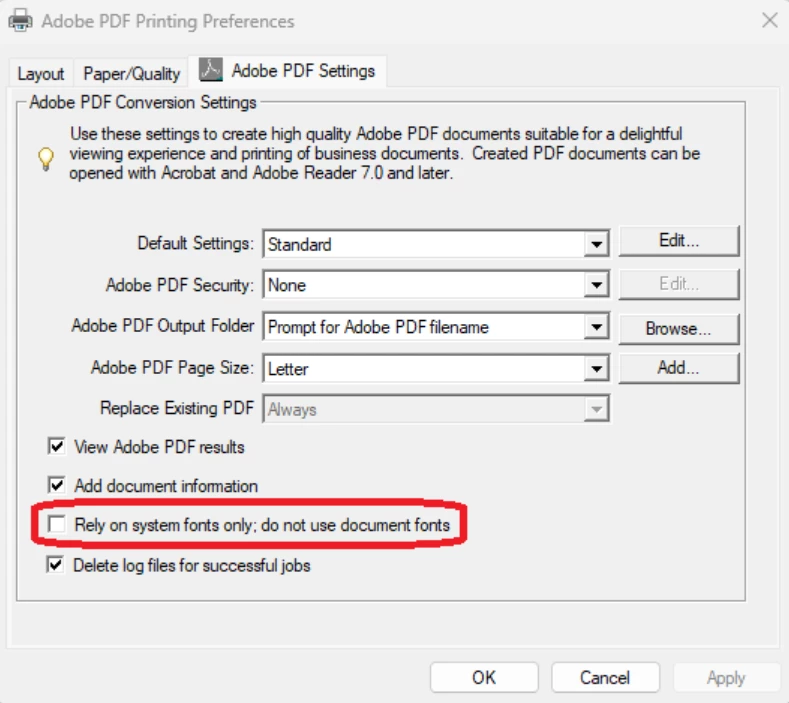

February 26, 2024
Hi @Carlisle1500
Hope you are doing well and thanks for reaching out.
Please go into the Printer Properties for your Adobe PDF printer, and on the Adobe PDF Settings tab, UNCHECK "Rely on system fonts only; do not use document fonts" as shown in the screenshot below and see if that works.
Let us know how it goes.
Regards
Amal

February 27, 2024

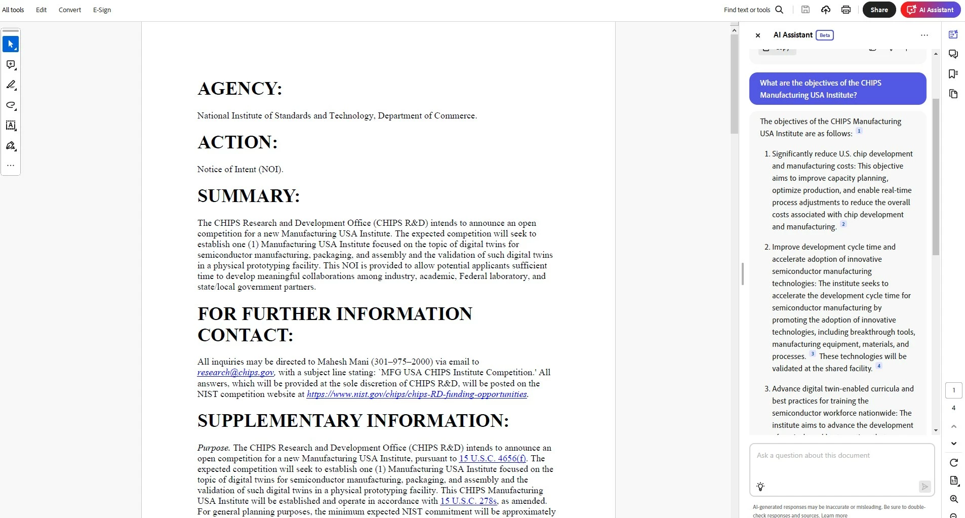

@Amal. Thanks. This issue closed and working. Also, the AI Assistant is working on this document now.
