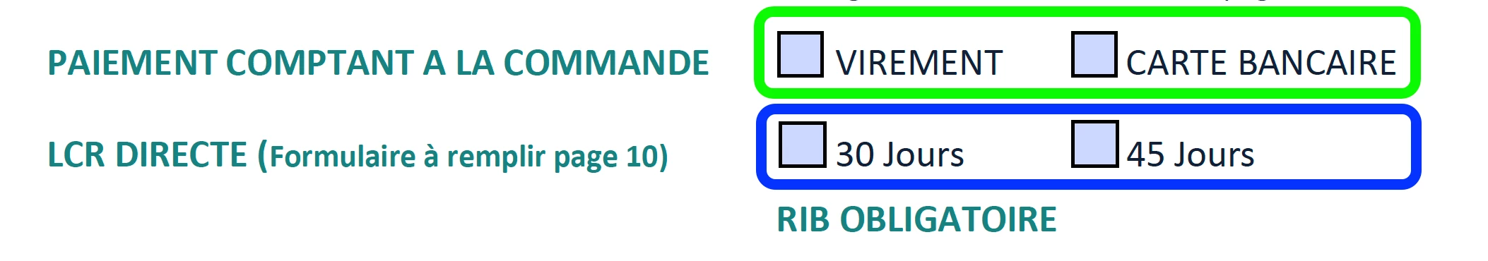

Bonjour,
Je souhaite que dans mon formulaire remplissable, l'action de cocher une des 2 cases à cocher du rectangle VERT rendre indisponibles les cases à cocher du rectangle BLEU. Il est donc impossible de cocher les cases de la case BLEUE.
Possible ?
Voir pièce jointe
Merci beaucoup pour votre aide,
Christophe GAUMARD
Correct answer PDF Automation Station
Enter the following custom calculation script in any text field.  I am assuming the green check boxes have the same name and the blue check boxes have the same name, which in the this example is GREEN and BLUE:
if(this.getField("GREEN").value!="Off")
{this.getField("BLUE").display=display.hidden}
else
{this.getField("BLUE").display=display.visible}

Yes, this is possible.  There are a couple of simple ways to do it, hide the other fields, or make them readonly.
Here's an article that shows how to hide/show fields. but the exact code could be used to make the fields read only by swapping the  "display" property in the code to the "readonly" property (and setting the value to true/false).
https://www.pdfscripting.com/public/Hiding-and-Showing-Form-Fields.cfm?sd=40
else
