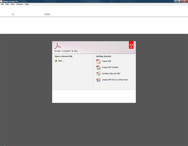

Hi all,
I have installed Acrobat X Pro together with CS6. Whenever I launch Adobe Acrobat X Pro, I don't happen to see any toolbars or menu bars on top. I have even uninstall and re-install again to no avail. I suspect it causing a clash with my graphics card, My graphics card specs is NVIDIA GeForce 9500 GS. I have updated the device driver as well.
However, the other Adobe CS6 products are doing fine. So what gives?
Here is the screen-shot taken :
Thanks for reading!
Correct answer clavin007
which tools are you looking for.  Adobe for some reason changed the tools to be on the side you can create a toolbar or show the navigation by right clicking any where on the menu, select page navigation and then show all page navigation tools.
Hi kgator,
Well thanks for reading this. I have already managed to solve the problem of the disappearing toolbar. All you have to do is to right+click on the Acrobat application and under Compatibility > choose run this program Windows XP.
Strange, it works after that.
Cheers!

I got the same problem.
To solve it is easy  --if you know how to do 🙂
Just pull the window bar at the bottom up and the windows bar will show up.
Apparently, the windows is so large that it covers the windows bar.
That's all folks!

None of the above worked for me.  After 1.5 hours I found my culprit:
What SOLVED my problem to view the Navigation Pane was to Deselect READING MODE (CTRL-H) under the View Menu.
Reading Mode had been accidently selected.  Once UNSELECTED, everything returned to normal.
Apparently there are multiple ways to hide the Navigation, Tool and Menu bars!!

Try this!
Go to Edit > Preferences
From Category select Page Display.
Under Rendering Pane uncheck the option 'Use 2D Graphics accelerator'
Then start Acrobat again.

Hi abhishamster@gmail.com,
I have tried according to your instructions, but it still does not work at all after restarting Acrobat a few times.
Are there any other solutions?

Press the F8 on your keyboard and check it works for you.

Hi prat_k,
Thanks for your reply. May I know what does F8 achieve? Is it some kind of refresh? No offense, but I think this is a more deep-seated problem than just pressing F8.
Strangely, When I was using Acrobat 9, it does not pose that problem. I felt by having Acrobat X Pro, it has much more problems than before.
James
August 9, 2012
F8 is shown as View > Show/hide > Toolbar items > Hide toolbars.
