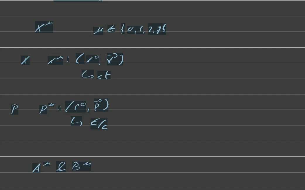

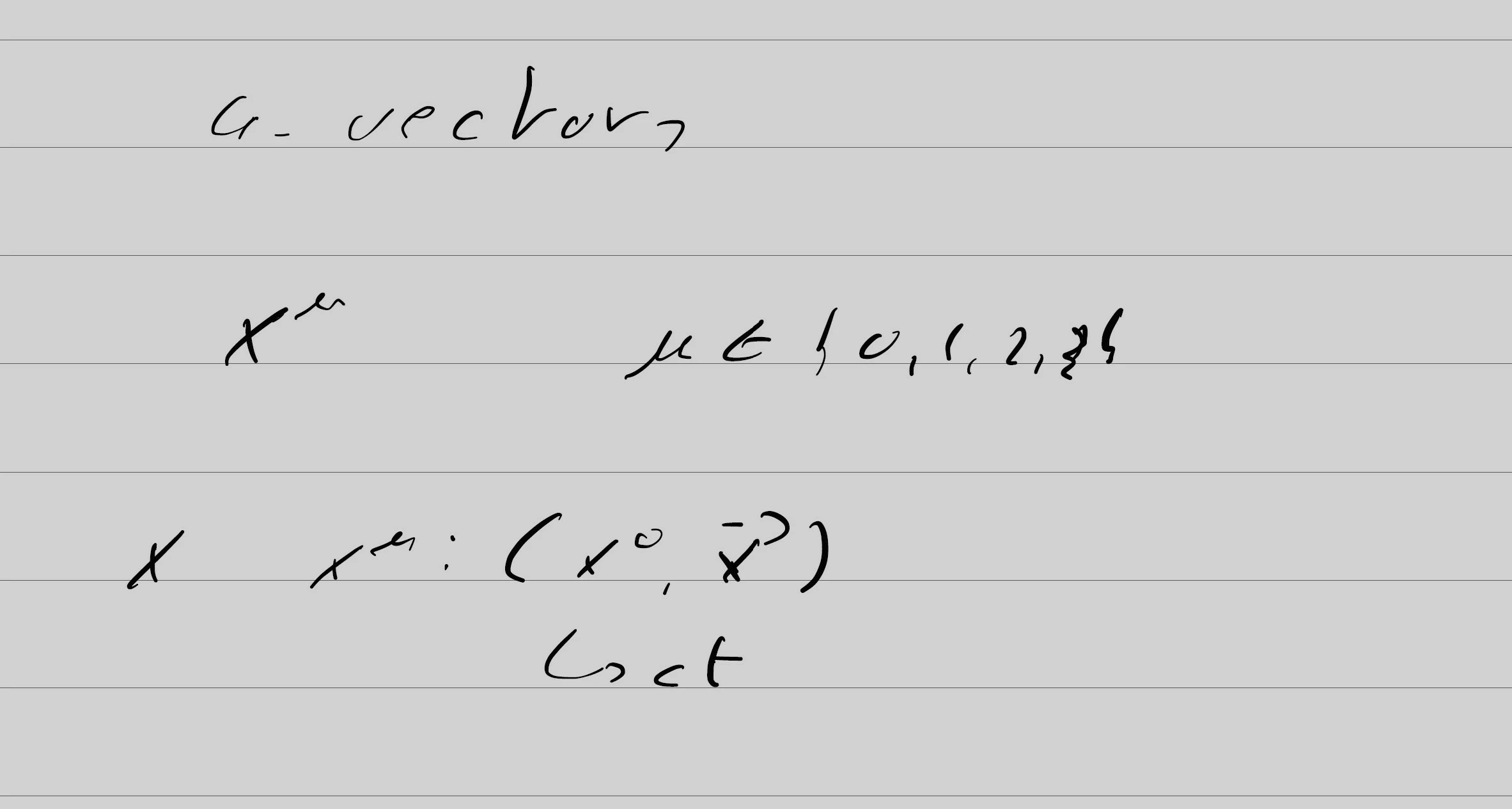

I have some handwritten notes in white and greyish black. I would like to print these in pure black text and pure white background. The handwritten text can be selected (see below).
Printing to pdf in greyscale with inverting colors leaves a grey tint.
The only way I got this to be actual white and black was through accesibility 'replace color' settings, which won't show up while printing. An example page is attached.

The problem is that these aren't made by me. My lecturer made these and insist that changing the colours is possible, so here's me trying to figure out a way.

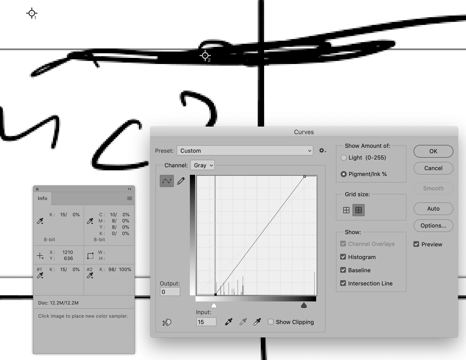

One way would be to open your PDF in Photoshop and do 3 adjustments;
Image> Mode> Greyscale,
Image> Adjustments> Invert,
Image> Adjustments> Curves, (-15% in the lights, +5% in the darks), save as a PDF from Photoshop.
If you're doing this frequently, you could create a set of Photoshop actions.
Note, your sample PDF is not viewing correctly in Acrobat for me, but looks OK in Reader and Preview. I don't know what the issue is, but saving from Photoshop fixes this issue as well.

While I appreciate the suggestion, I don't have acces to photoshop. I was hoping acrobat pro had an option to do this. It's kind of frustating that the accesibility option does exactly what I need and yet it doesn't print that way.
I might have to live with the grey hue left behind by this.
