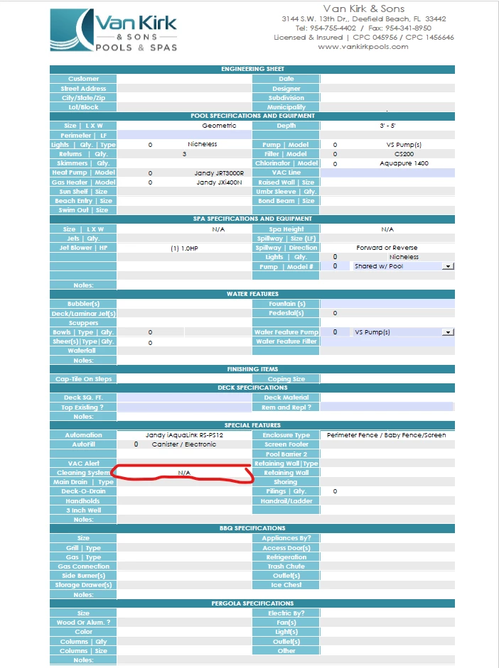

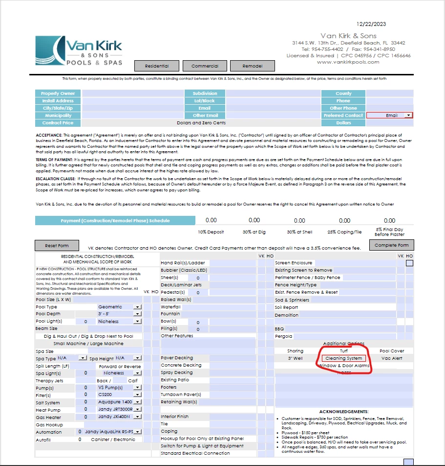

I am working on a document for my company. There are some options that I want to directly correlate to another sheet. See attached screenshots.
The ideal scenario is:
If the user select "Cleaning System" on sheet 1, the border color will change to red. Once the border changes to red, the field value on sheet 3 will read "Yes". If the user deselects "Cleaning System" on sheet 1, the field value on the sheet 3 will read "N/A". I've done this before with check boxes, but not sure what the export values are for buttons. Any help is appreciated. Thank you!

Use this:
this.getField("Cleaning System Eng").value = (color.equal(color.red, event.target.strokeColor)) ? "Yes" : "N/A";
