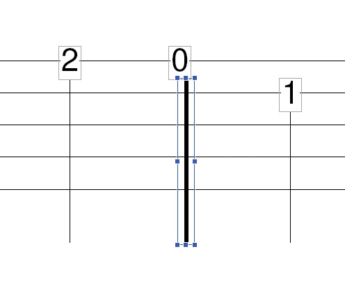

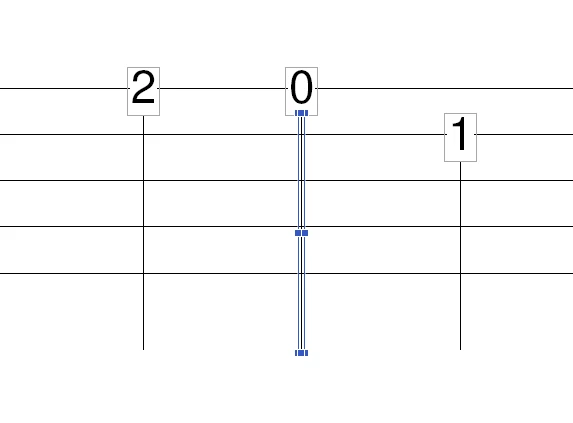

Using this tool click one of the lines so it's selected:

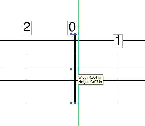

Then hold & drag one of the squares in the center to make the line wider:
After you do that the line will be misaligned with the number above it, though:
So use the arrow keys to move it back to the left:
