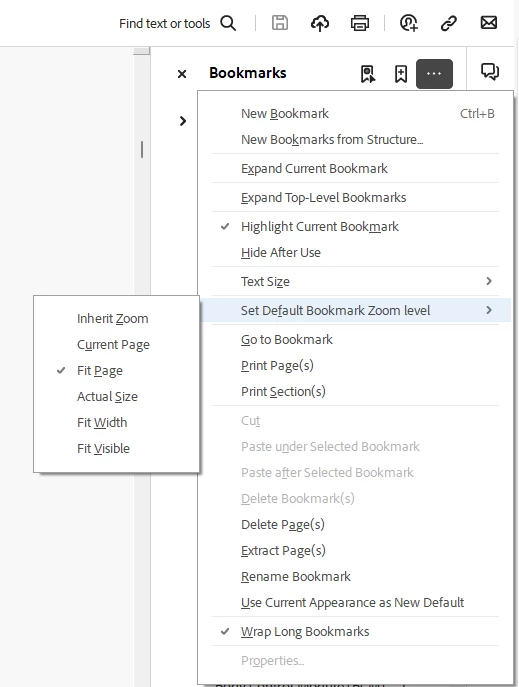

Yes it is possible.  Here's how:
  1.  Select all of the bookmarks
  2.  In the Bookmarks toolbar, click the three dots on the right of the toolbar to expant the bookmarks fly-out menu
  3.  Hover on to Set Default Bookmark Zoom level menu option to expand the flyout menu
  4.  Check on one of the six options
  5. All bookmarks are now the zoom option you selected in Step 4
See screenshot image below that shows where to find this option:
Feb 15, 2024 11:18 AM UTC
Doesn't work.
