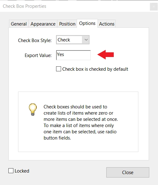

Go to checkbox properties and under 'options' tab check that export value is set to "Yes" (which is by default, if you set it to something else change it in script from "Yes" to value you set, See photo bellow).
Put this script in "Age" field under validation tab as "Run custom validation script":
this.getField("CBOver10").value = event.value >= 10 ? "Yes" : "Off";

Sorry for the late reply. This works great, thank you!!
