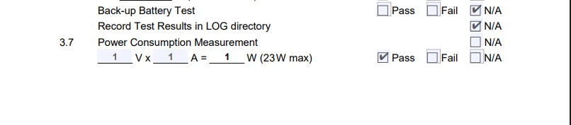

karthick
December 13, 2025
Checkbox enable and disable
I need a PDF script based on the concept. Could you please help?
can not write N/A in section 3.7 and also write PASS or FAIL
if section 3.7 is N/A than below fields are not enables
if section 3.7 is PASS than upper line should not be enabled (see snapshot)

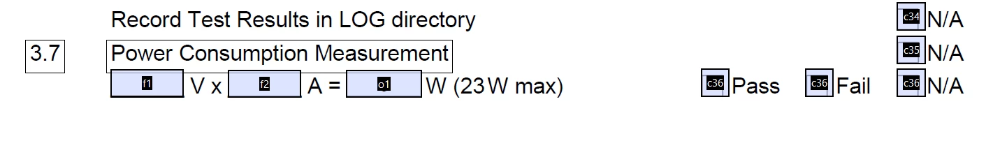

karthick
karthickAuthor
December 14, 2025
Hi Nesa, Thanks for your help.
The checkbox name is the same, but the value is unique.
Here you can see the field names:
Nesa Nurani
December 14, 2025
Can you explain exactly which fields should be enabled/disabled and when?
