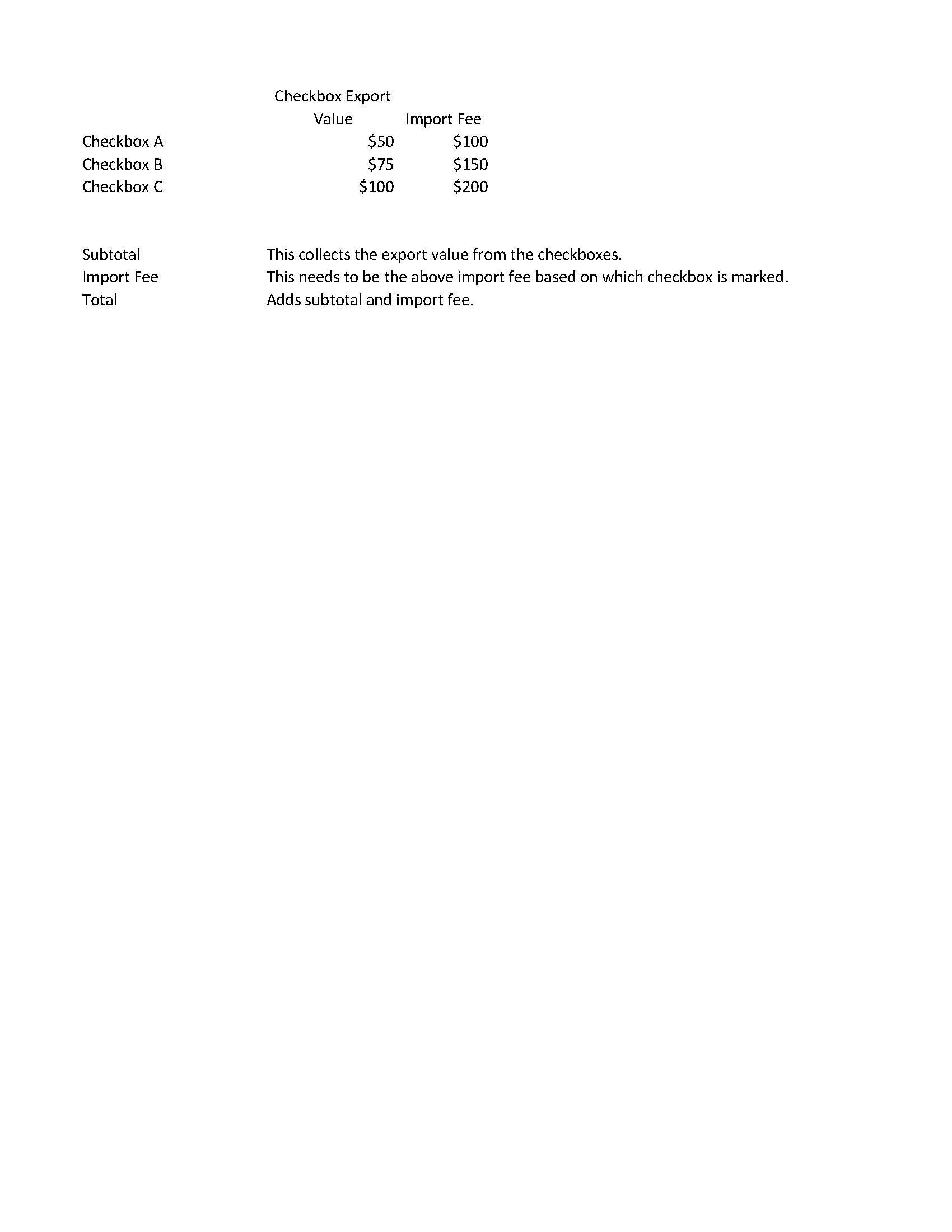

Hello all, I've run into a JavaScript problem that I'm having trouble solving (and hopefully I can explain it properly).
I have a form that is calculating totals depending on which checkboxes are marked.
I've attached an image of an example of what I'm working on (it's not the actual form but a simplified version that I made in a spreadsheet).
I currently have the checkboxes set up to export a value so for example, if Checkbox A is marked, it exports a value of $50.
What I need help with is the Import Fee textbox. I need a script that takes the export value from each checkbox, and it triggers the Import Fee based on which checkbox is selected.
For example, if Checkbox A is marked, then the Import Fee will display $100. If no checkboxes are marked, the total needs to be $0.
Only one checkbox will be marked per form (but the form is not setup with radio buttons) so the import fees do not need to be added up.
I'm having trouble with getting the script to look for more than one export value from the checkboxes. I can make it work for one checkbox, but not multiple.
Any help is appreciated!

There are other solutions to this, for example, since only one checkbox will be checked and import fee is double that value just calculate "Import Fee" field to be Subtotal*2.

Sorry about that, I was a little unclear about the math. The totals above are an example. The actual math is more like Item A is $1471 and the import fee is $410, Item B is $425 and the import fee is $110, and the rest of the items and import fees vary.
I was able to get this JavaScript to work for one checkbox:
event.value = this.getField("CB2").value == 1471 ? "410.00" : "";
But what I'm having trouble with, is writing event.values for more than one event. If I could just get an example of how to write it for two events, than I can figure out the rest.
