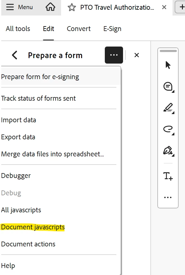

Thank you.  Unfortunately, this is how I had to handle this, but creating a document level script to check and then uncheck the fields.  The linked article is a bit dated and is unclear on exactly how to get to the document-level Javascript console.  For the lates version of Acrobat as of this writing, you need to go to the All Tools menu and select Prepare a form.  Then click the 3 dots to the right of "Prepare a form" and select Document javascript.
Nesa Nurani
September 13, 2024
When you select 'Prepare form' tool, you can use a shortcut to open document JavaScript SHIFT+D.
