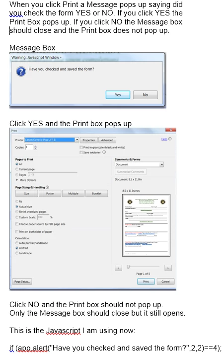

SEE ATTACHED IMAGE
When you click "Print" a "Message" pops up saying "Did
you check the form" YES or NO. If you click YES the
Print Box pops up as it should. If you click NO the Message box
should close and the Print box should not pop up but it does. How do I stop it from opening when clicking NO?
This is the Javascript I am using now:
if (app.alert("Have you checked and saved the form?",2,2)==4);

Did you add a separate command (most likely "Execute a menu item" - "File>Print..." one), after the Execute a JavaScript command? If so, remove it, and change your code to the following:
if (app.alert("Have you checked and saved the form?",2,2)==4) this.print();

The Print command is in a box at the top of the form. I am actually thinking of changing the YES/NO to just OK so when they click OK the print box opens or if it's the Save As then the Save As box opens. Much simpler.
September 18, 2021
Ah, there's the problem. Each action is separate, and one action can't stop the next. So you can do anything in your JavaScript and it won't stop the separate print action.
The solution is to lose the print action, and instead put a print JavaScript command into your script, run only if the user says Yes. (So, think in terms of "confirming print then printing" rather than "cancelling print").

We need to understand what you are doing. How, in particular, is your code called? For example is it the "mouse up" action for a button you added?
People often focus on the lines of the code, but just as important is how the code is called. Something written for a validate action won't work on a calculate action. Something written for a mouse up action won't work on a DidPrint action. And so on.
September 18, 2021
Your code shows an alert box. But your code does nothing with the user's answer - yes or no.clearly, then, the response has no effect.  Nor does your code include a print request, we're only seeing half the story. (Tip: the WILL PRINT action means what it says. It WILL print, The action is not given a way to stop it)
