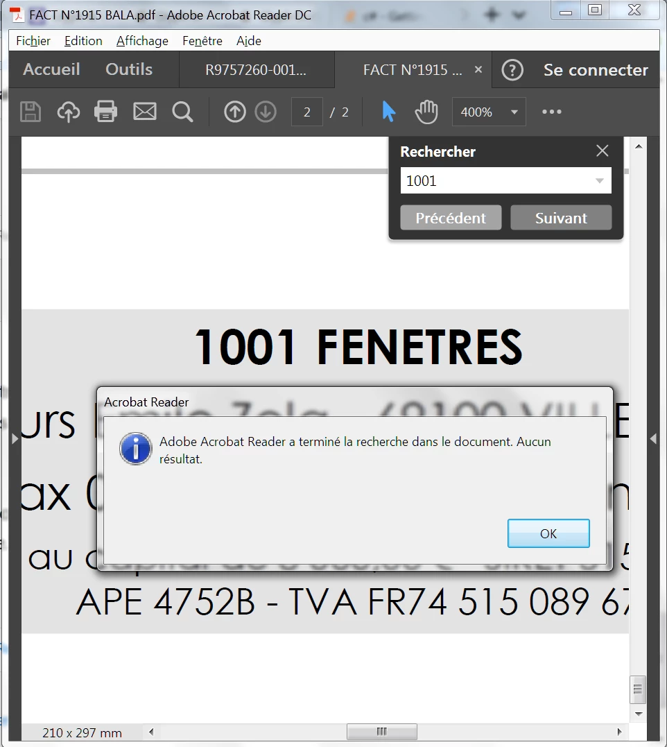

That looks like a viewer screen shot. PDF viewers do not use text extraction. They MUST use embedded fonts, accessed via CMap or Encoding. For embedded TrueType fonts with Identity-H, the character string contains GID values. No other possibility exists.
Buy you are talking about text extraction, so please compare with Acrobat's text extraction. For example, copy/paste text. Pay close attention to the encoding when you paste.
Oct 26, 2017 11:43 PM UTC
This is a Acrobat Reader screenshot.
Let's look at another example, searching for text "1001" in PDF (FENETRES has the same result) :
I did my own text extraction and here is the ouput for the text "1001 FENETRE" in debug mode (last cols is CID+0x1d) :

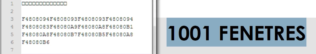

What do you mean "this"? You cannot email a picture. If you want to post a picture you must return to the forum to post it.
Oct 26, 2017 10:18 PM UTC
Oh, sorry, I'n new here and didn't thought the text would be transocded to space by the forum (or my browser).
I copied text "1001 FENETRES" from PDF viewer in acrobate.
On the screenshot below, you can see on the right, the pdf viewer and on the left the "squares" correspond to the copied text. Below that, the converted string ASCII -> HEX from notepad++
Those characters do not match against the ascii or unicode table.

This forum is for questions about Acrobat. Have you tested whether Acrobat can extract text as you wish?
Oct 26, 2017 9:56 PM UTC
This is not a question about acrobat but about PDF parsing.
Sorry about that, I didn't fint the correct forum.
Extracting text from Acrobat gives me this :
As you can (or can't see), the code are 0014, 0013 as in the text editor.
I'm starting to think that PDF doens't display btext ut "glyph" and "fgpm" that corresponds to the partial TTF embedded font file.
